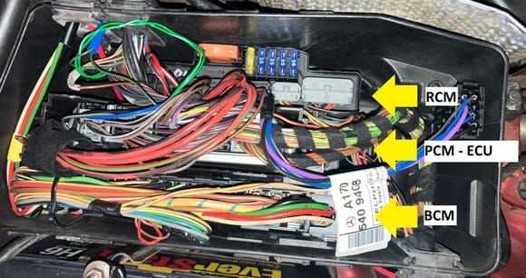

A failure in the "Traction Control Relay Output" (TCRO) in the RCM means that the ABS module has no power, and that causes these symptoms:
  • ABS light on
  • BAS/EXP light on
  • Odometer doesn't work, speedometer doesn't work.
  • The spoiler is always open/up
  • The ABS controller will not work or respond to any scanner or diagnostic tool.
I believe that your RCM's TCRO is bad, so put in a new RCM:
https://www.autohausaz.com/pn/141401...BoCgJQQAvD_BwE
You can change this yourself, it plugs in and you need NO tools. It is in the box next to the battery:
