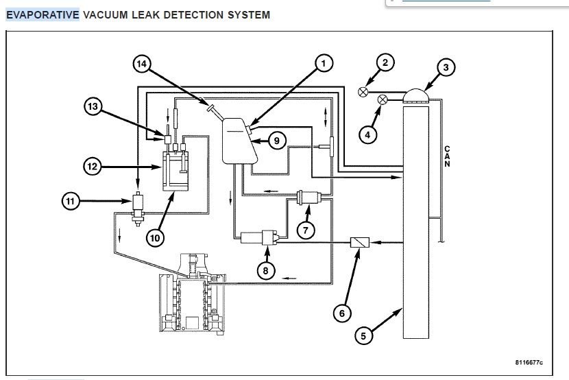

So now where is the vent line? Im asking me that question too.
Old Apr 1, 2024 | 01:11 PM
Anthony C's Avatar
Joined: Mar 2024
Posts: 13
Default Re: there is fuel in the charcoal canister !
Here is a rough diagram of my EVAP system.
Comments and suggestions are welcome.
Anthony, I know this a year old, in reading this thread, I never saw a final root cause. I am too getting fuel in my canister. As shown by this picture as I got gas all over me when I tilted to the pressure release line. Did you find a root cause?
Gas came out.
Gas came out.
I think your diagram is close. Here is the one out of the manual.
