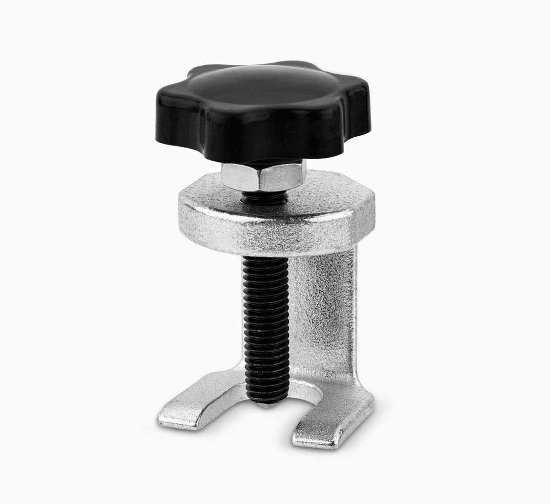

Get a wiper puller from Amazon or Harbour freight $6-$15
Before you remove the wipers go to a pick and pull and get a wiper grommet from a MB
Match the one on the passenger side
Our Cars did not come with one in the driver side. Several posts about this too.

Thanks, picked up the puller this AM and they popped right off. Removed the siren and no more noise, amps dropped down from 0.30 to 0.16, looks like I still have a issue on fuse #9. I will check further. Thanks again
