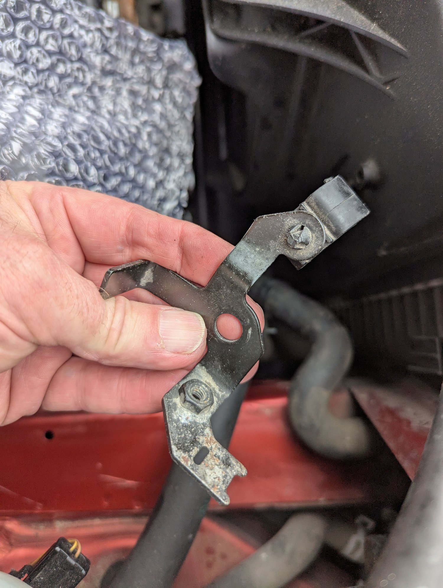

While removing and replacing spark plugs, I noticed there is a bracket just hanging loose attached to a cooling hose. Does anybody have a picture showing the correct mounting location for this bracket?
I have no idea where this goes.

Was that bracket loose on the hose? If it is not loose where you found it, take a picture with the location in the center of the picture is (back a bit) where it came from so ppl know whereabouts to look for a bolt or screw where it was originally mounted (I've been under my XF hood but never seen that unless bases on the angle of the bracket it is partially covered by something else under the hood). There is quite a number of feet of hose there under the hood...
Once we can know a narrowed down location (hence where it loose/tight on the hose), we might be able to assist where it belongs (closer area to look for it's mounting point).

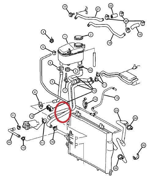

Updates
I forgot to download the picture showing the location of the bracket. I did a bunch of research through the parts manual looking for a match, no dice. It was located on the two hoses going to the duo-valve. I have marked the location where I found the backet on the following diagram.
location of found loose bracket

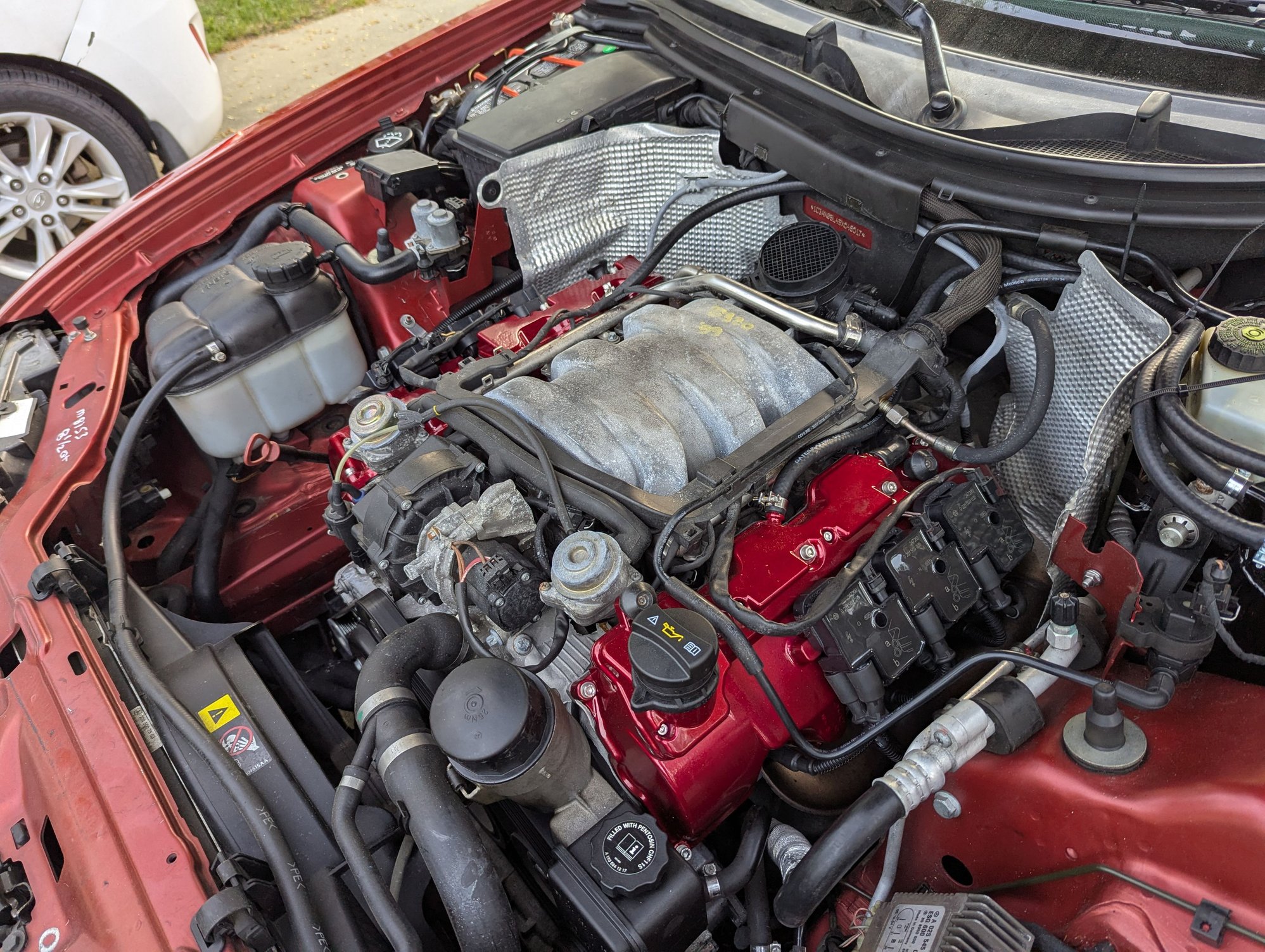

Now the COOL news. I got my valve covers powder coated. I am very happy with the job.
pretty
pretty
just for show
just for show
more for show
more for show
While the color is not a match, it's an eye popping red that will get attention. YES, I know. Once you put the air box on the engine, you can't see the beauty. Maybe in the future, I will go to a modified cold air intake and get the intake header coated. I mostly did this for protection as the original valve covers look like doo.

The valve covers look great! You will be able to see some of them even with the cover on.
If you're reusing the original screws, don't over tighten them. I tightened mine until some rtv seeped out. I waited an hour then torqued them down to about 2 to 2.5 Newton meters/24 inch pounds.
I've included a couple of pics from my post, including one with the torque sequence. Good luck!
That diagram is sure hard to follow, I can't place that bracket there but I'll look around my 08 in that area to see if I can find something that looks like it. One thought, is your duo-valve mounted on a bracket that mounts on the side near the wheel well? TBD.
The diagram shown by OP is for a SRT6. He stated in the first post and the pictures show an engine bay of a Limited. The hoses are NOT the same of the two models. The SRT6 from the factory has an additional hose routed to the bottom of the reservoir coolant tank that the Limited does not have. Also notice in the diagram the two small hoses coming and going to the intercooler.
That is not the correct diagram for a Limited.
Thanks for the clarification Zip! Now I know why I was so confused (we all know how diagrams are not that accurate in the SM anyway). I did see my duo-valve assembly, it just might be part of that bracket assembly (seems the duo-valve and the PS heat shield are on a bracket, without taking mine apart I have no idea if they overlap (two brackets together) or if the one bracket is the same as what he showed in his post.
xintersecty, is there a bracket on your duo-valve that mounts both on the wheel well area AND goes into the engine bay area to hold the front of the firewall/engine heat shield? That's about all I can see inside my bay where the duo-valve is located. Good luck!
I got my documentation from this link:
https://www.crossfireforum.org/forum...ollection.html
The parts catalog I used to extract the picture was labeled 2005 Crossfire Parts. I believe it covers both the limited and the SRT. So the picture I picked very could be for both. Again when you have senior members who know more about the car than the manufacture, you are going to get the details you need. And, that's a good thing,
Here is a picture of my duovalve.
Yes it's located above the passenger side wheel well. I am going to take another look in the car and chase down those lines. This is really weird. It could be some random addition to my car. The backet was mounted near the radiator closer to the fill tank. See the picture above when I removed it.
Currently, I am waiting on a needswings order (Thanks Rob) as my oil cap got busted and decided to replace the oil filler neck. I just ordered new oil for the oil change that will happen once everything is put back together.

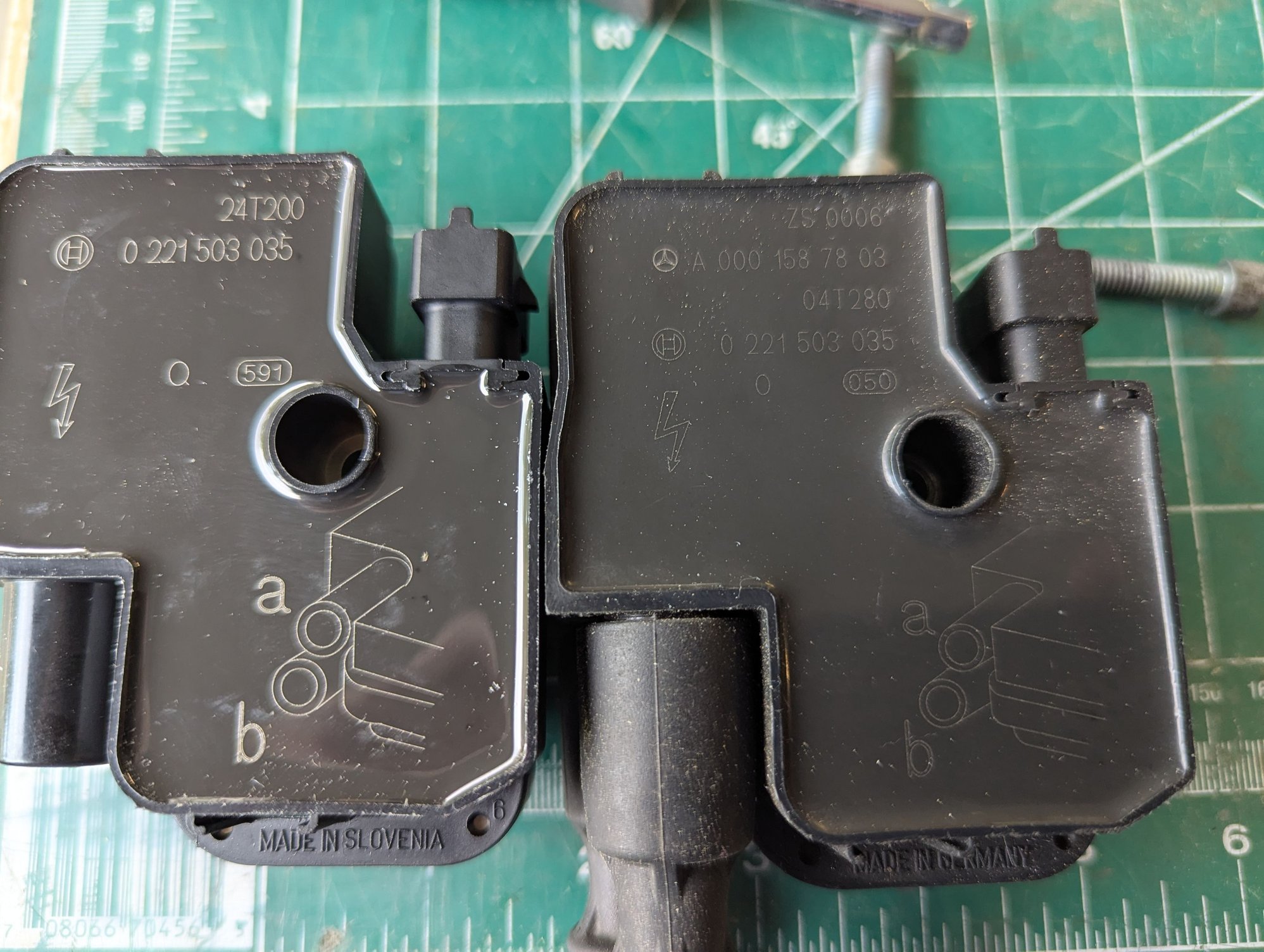

I got the new Bosch coils and made in Eastern Europe:
New coil on the left. Made in Slovenia
Here is two pictures showing the new powder coated valve covers. If any oil leaks it should be easier to clean. I did go through and steam clean the the engine bay.
So after much work, getting everything put back together. I went for test drive and go the same DAMN hesitation. Car does idle better and the output on the exhaust is cleaner.
So based on reading, the next thing to replace is the fuel pump and the fuel filter. I got those ordered.
