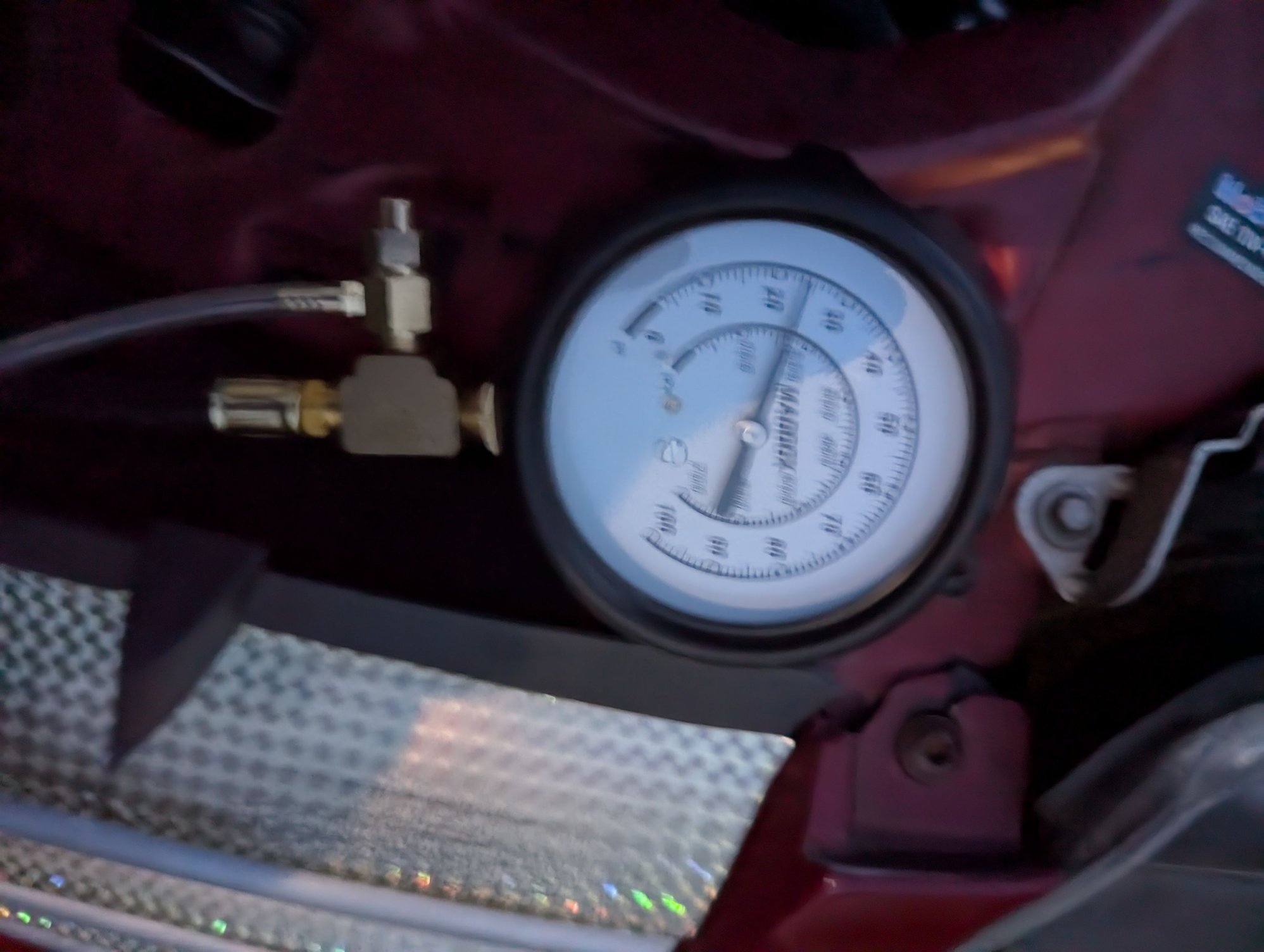

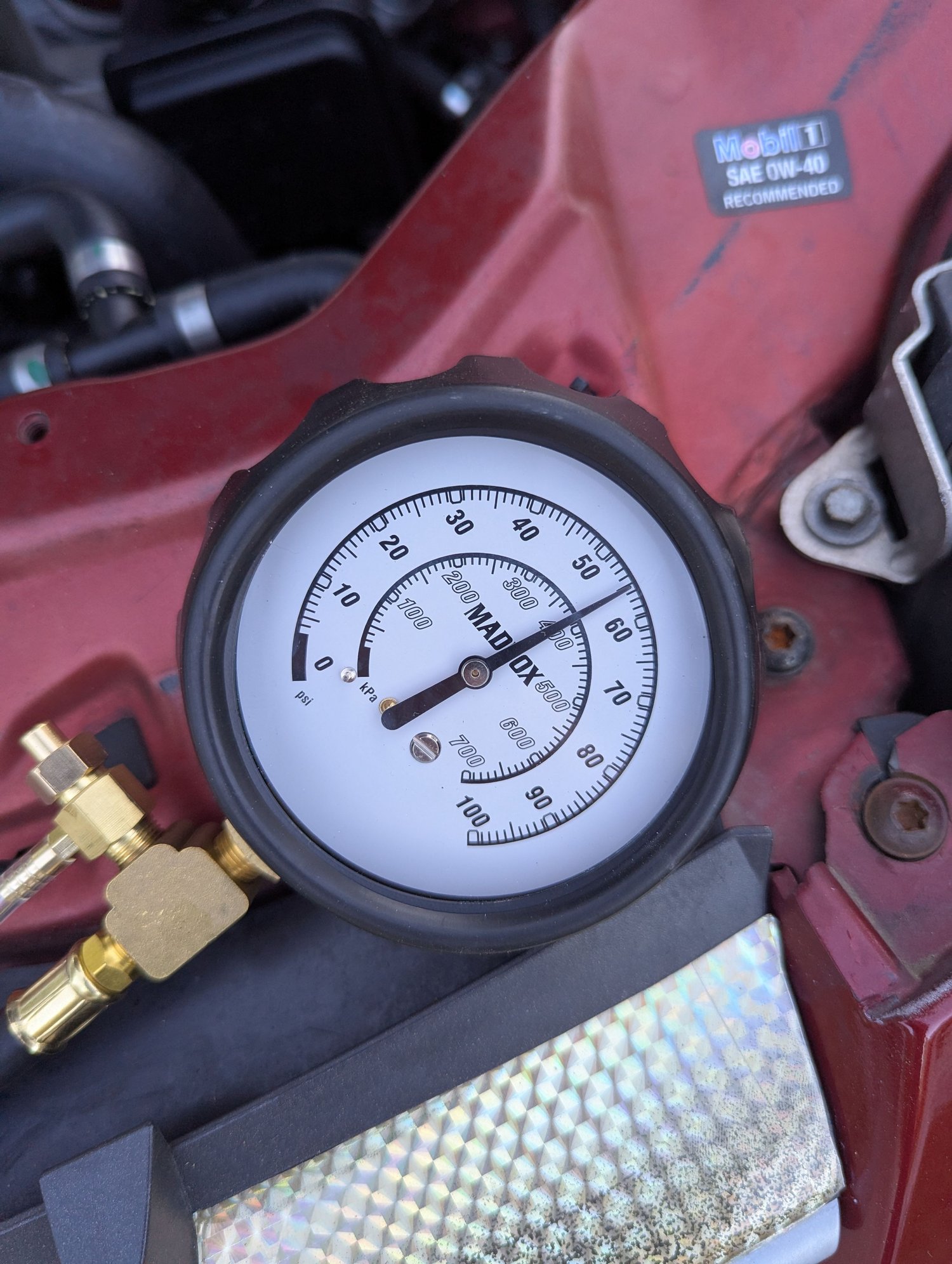

It's not science until you write it down. Well I took pictures and going to write it down.
I got a fuel pressure tester from HF and run some tests last night based.
Running Pressure
60 PSI while running
Fuel Pressure with engine off:
Fuel Pressure after turning off 55 PSI
Fuel pressure after long wait ( GF and I were practicing **** dancing (not what you think it is) and it got dark). Estimated time about 45 mins to an hour.
About 45 min wait, pressure drop to 24 PSI
I get only one fault on the scanner with ODBII
P0454
P0453
P0453 Evaporative Emission Control System Pressure Sensor High Input
During Idle, the car will start to slow down and shutoff. The fuel pressure does not drop. I am not sure about the cause. I did replace this valve located here:
2005 CHRYSLER CROSSFIRE 3.2L V6 Exhaust & Emission : Vapor Canister Purge Valve / Solenoid
So I am stuck. I don't have enough engine codes to say what else to replace.

The fuel pressure drop is a little higher than I would expect for 45 minutes. It makes a difference with a warm engine and hood down will maintain higher pressures; With hood open and a cool engine your pressure drop may be normal. With my car when engine running I get 55~56 lbs pressure. When engine is shut off pressure immediately drops to 51 lbs: After a hour it drops another 15lbs to 36 with a hot engine.
Needswings has a good price on accelerator pedal. I really think you should get a new pedal to, hopefully repair the hesitation at idle.
The P0435 code is a simple circuit to deal with as only three wires run between the pressure sensor in the fuel tank to the PTCM. However, it is a pain to get the plastic divider off the fuel tank to get to those wires. As M60Adriver suggested before trouble shooting that code you should get a new gas cap. The caps are double pressure relief as they allow both high pressure and vacuum to normalize through the cap. We are talking like 0.5 lbs. of pressure so it isn't much. So before messing with wiring I think it is best to first replace the accelerator pedal and the gas cap.
