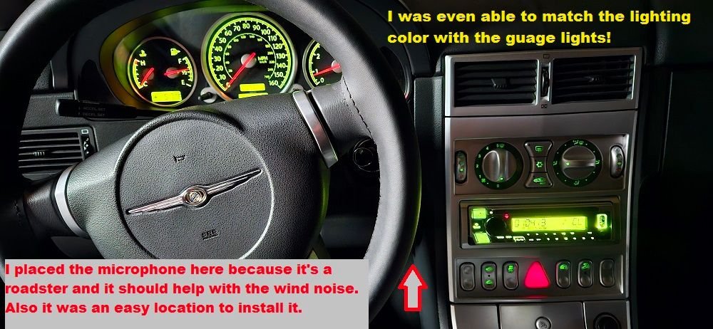

Do you know what number fuse it is? If it's number 9, that is most likely the alarm siren. You can just remove that. I have a post about that if you need help.
If it is the radio, then RJNeal is correct, your best solution is to replace it with the Kenwood. I asked about refurbishing my original, there's a Becker repair place 10 miles from me. They told me around $300 to refurbish $350 - $400.00 if I wanted to add blue tooth.
You can ask Crutchfield to make you an adapter so that there is no splicing (plug & play). Mine was $24.00 extra, but well worth it.
Here's what mine looks like. (The pictures are from a post I did when I installed mine).
