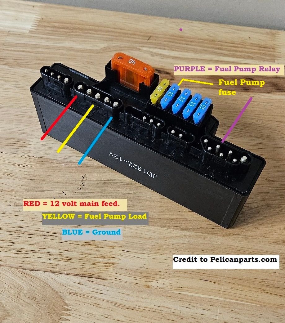

Make sure the connector on the RCM is tight or that the wire isn't broken or loose.
The only fuse for the fuel pump is the one on the RCM as far as I know. See the picture below for details.

thanks but as I just said I bought a brand new rcm so its not the rcm
