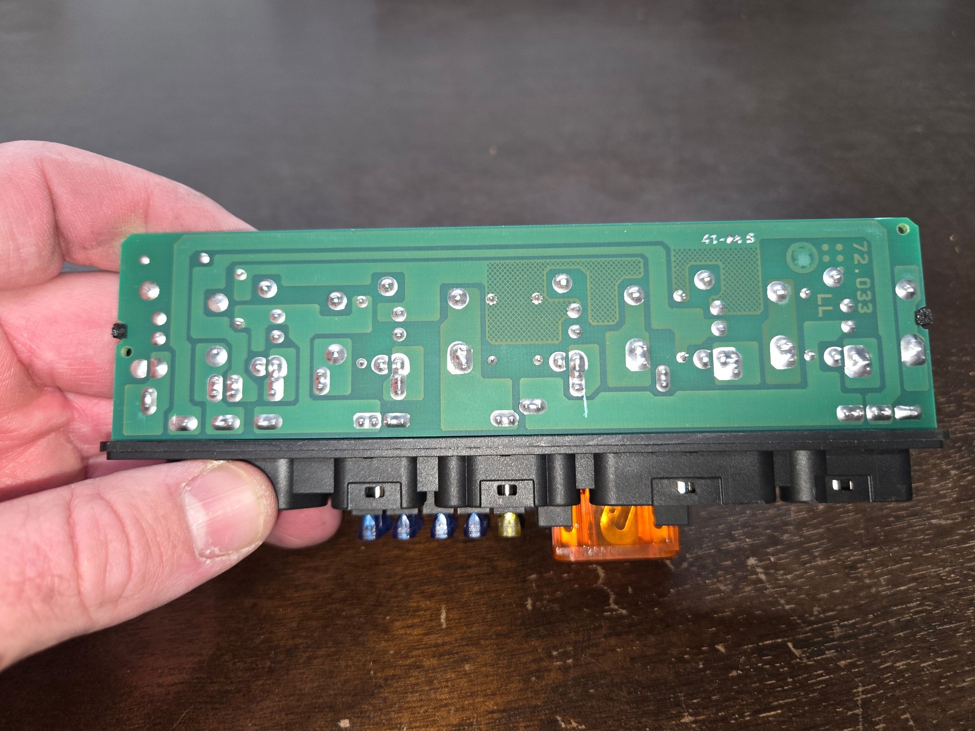

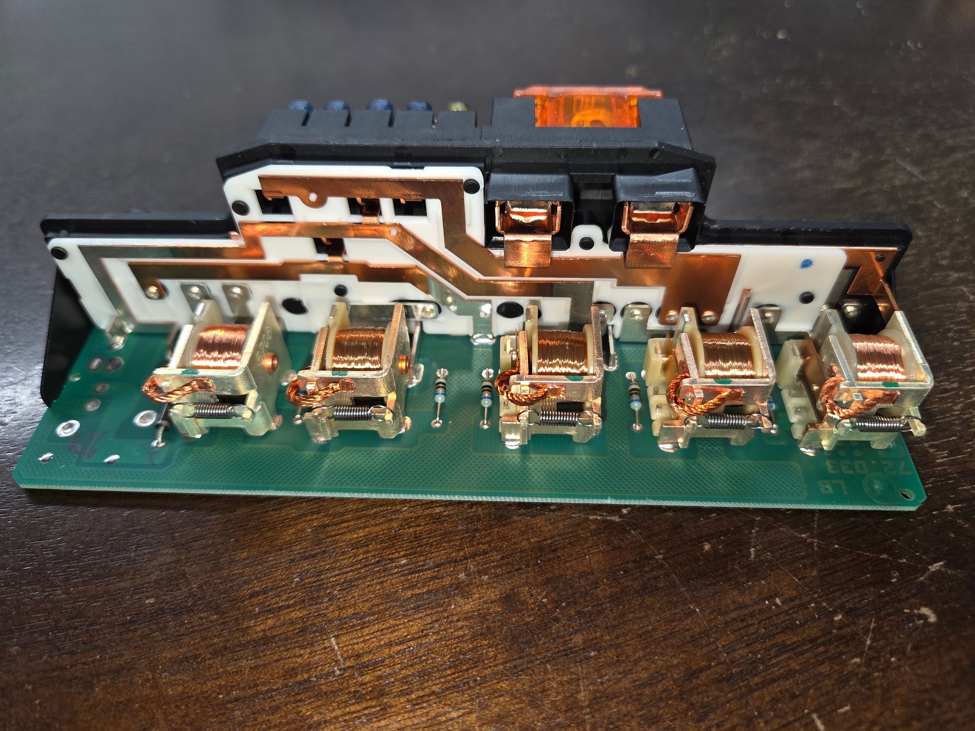

I bought this one, too, when I sent the OEM RCM to DJ for repair & upgrade. It's still in my 2007 Coupe! DJ's RCM is my spare.
Old Nov 24, 2025 | 01:20 AM
Posts: 3,268
Likes: 1,799
Default Re: Crossfire SRT6 died at stop light and now will not start.
DJ's is my primary, that one in the picture is my spare. When I get some extra cash, I'm going to send that new one out to DJ to have the me so horny mod added and so that he can make sure it's good to go.
