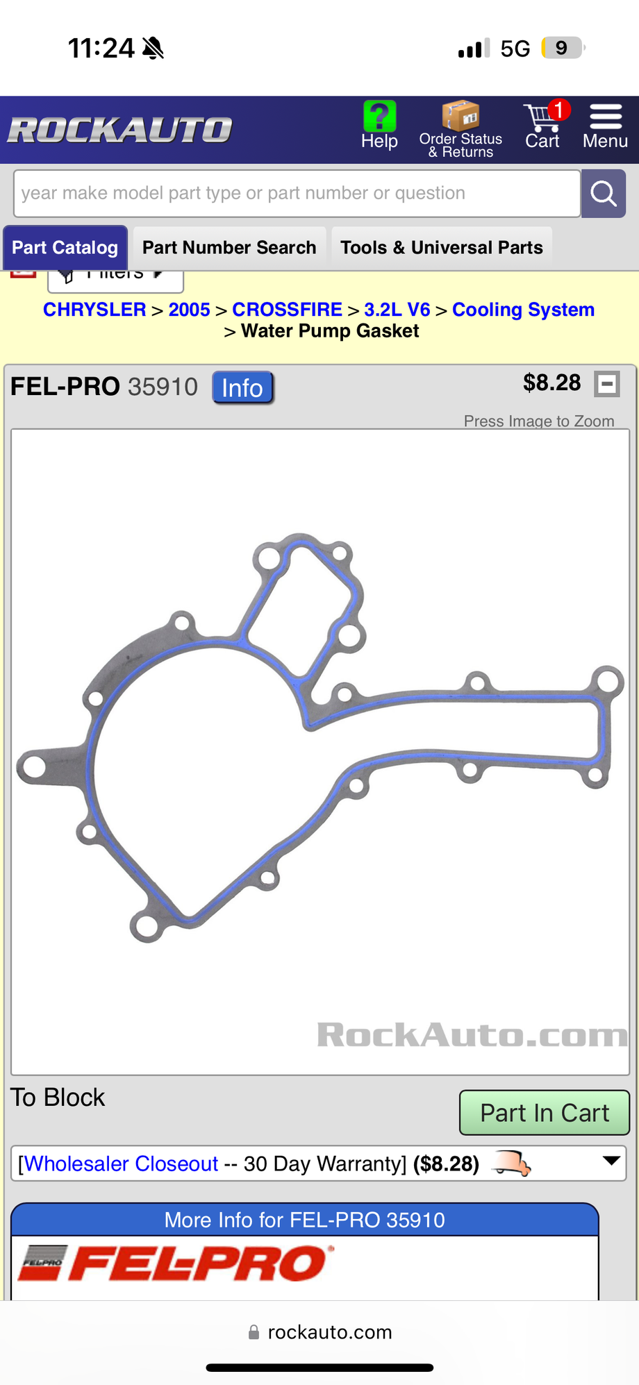

Thanks for the replies, I checked needswings, he only has the rubber gasket for other models doesn’t fit the limited. Does anyone know if this one works with the limited? Or is the added rubber going to add unnecessary space?
Thank you!
Thank you!
Personally I would spend the extra money and go with the MAHLE / Clevite gasket. It's more like the original gasket.
Also, when you take off the original pump, take pictures of where any rtv sealant was, if there was any.
There should be no difference in space as far as the gasket is concerned. It will crush against the block once it's torqued down.
