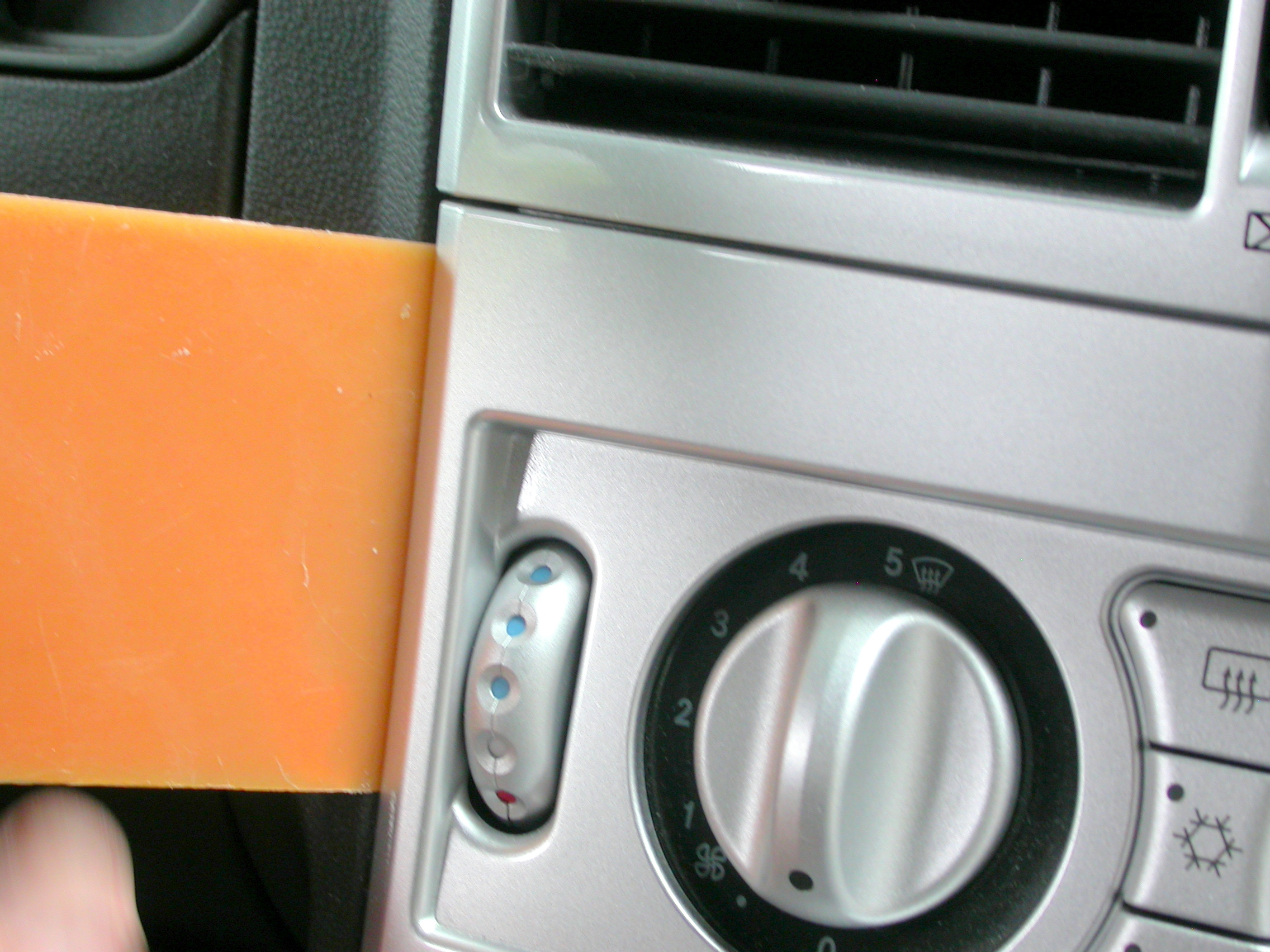

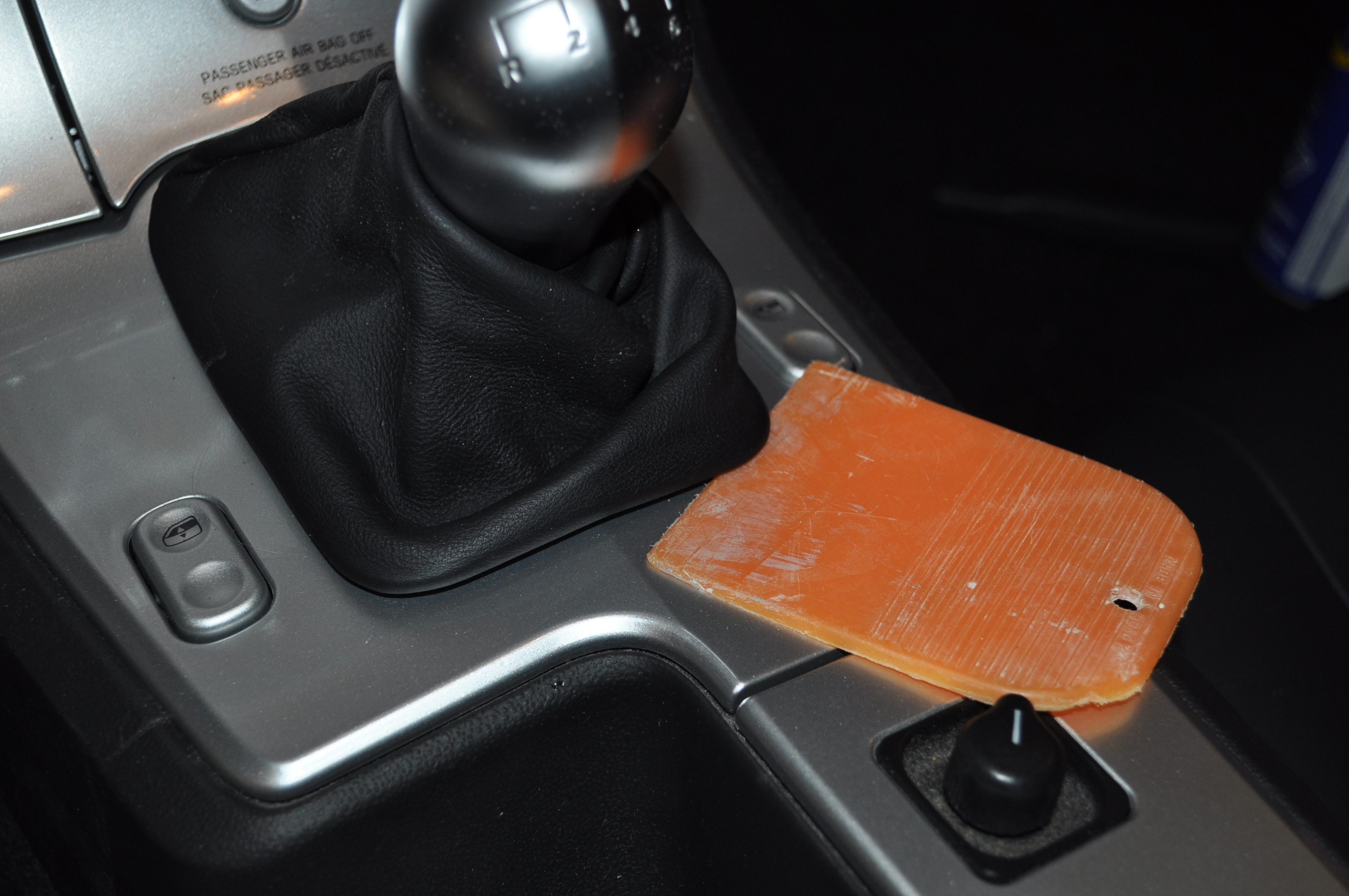

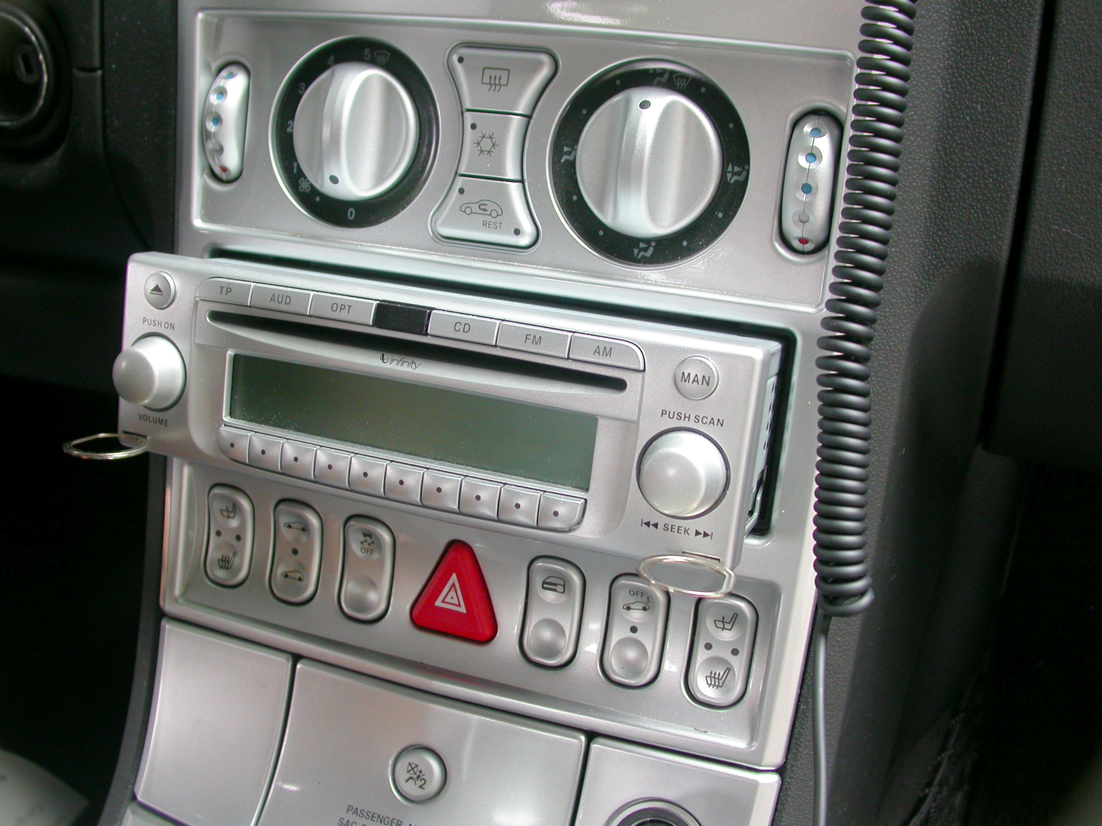

it is the INTERNAL trip I want to remove, the silver plastic around the gear shift and radio and centre air vents.
Old Apr 5, 2013 | 10:36 AM
Likes: 651
Default Re: Another Trim Question
Here is the way to remove the manual trim, the auto trim is very similar without the gear shift boot and is removed in the same manner.
The radio surround is removed in the same manner except some screws are hidden from plain view, see the following thread to see the location of these screws (post #30) and the way to remove the radio.
See also this (click)
