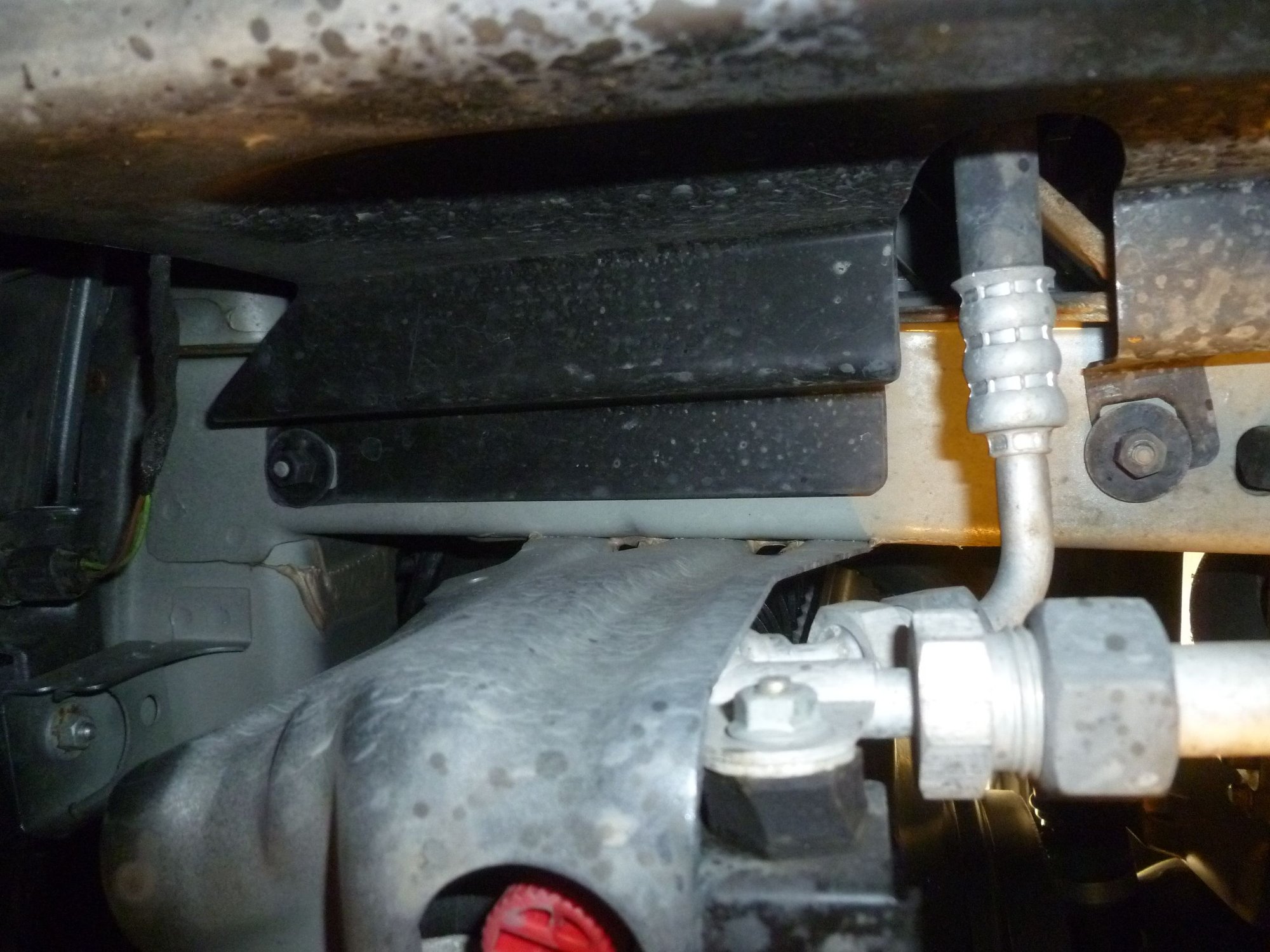

i just replaced the the right one, the 2 inner nuts were a bear to get to from inside the engine compartment.
I'm thinking of changing out the left one as the access door is going for the same amount as the whole fender liner.
But, there isn't any room on that side to get at those two nuts, how did you make it happen?

If you are talking about the 2 nylon 10mm nuts on the bottom, then just drop the belly pan.
( good opportunity to clean all the junk out of it anyway )

no, the two nylon nuts on the top, they screw onto two threaded studs that are a part of , oh s...t i don't know what it is called maybe sub frame???

I went back through my photos of last week after I read what you had to say about dropping the cover, as soon as I read that t clicked. yeah fought the right side from inside the engine compartment but looking at it now I can see how access would be there after dropping the cover.
The one photo shows the bolts in the frame, because I just ripped out the old one until I could see what was holding it on that side, ha.
I need to drop the cover anyway to replace the steering stabilizer and (too clean out all of the "stuff", as you put it) so I guess I'll buy the left one at the rock and replace it also. As said earlier, at least these parts have that access door on there semi permanently.

Yep those 2 tabs that I circled in the photo are on the inside of the Inner fender liner, I made a mistake calling them nuts, actually they are 2 bolts with a large washer attached.
I can see getting at them from below as ala_xfire mentioned or as I did by going in from the engine side and performing gymnastics to get at them. Possibly they could be gotten from the other side by pulling the part back before attaching anything else. I didn't try that, but it could be the only way that I can see you getting them from the inside of the wheel well.

I just ordered the left side now that I know that I can get at the two inside bolts/nuts by dropping the belly pan, thanks

I dropped the belly pan and looked up on the left side and wow, look what I see.
