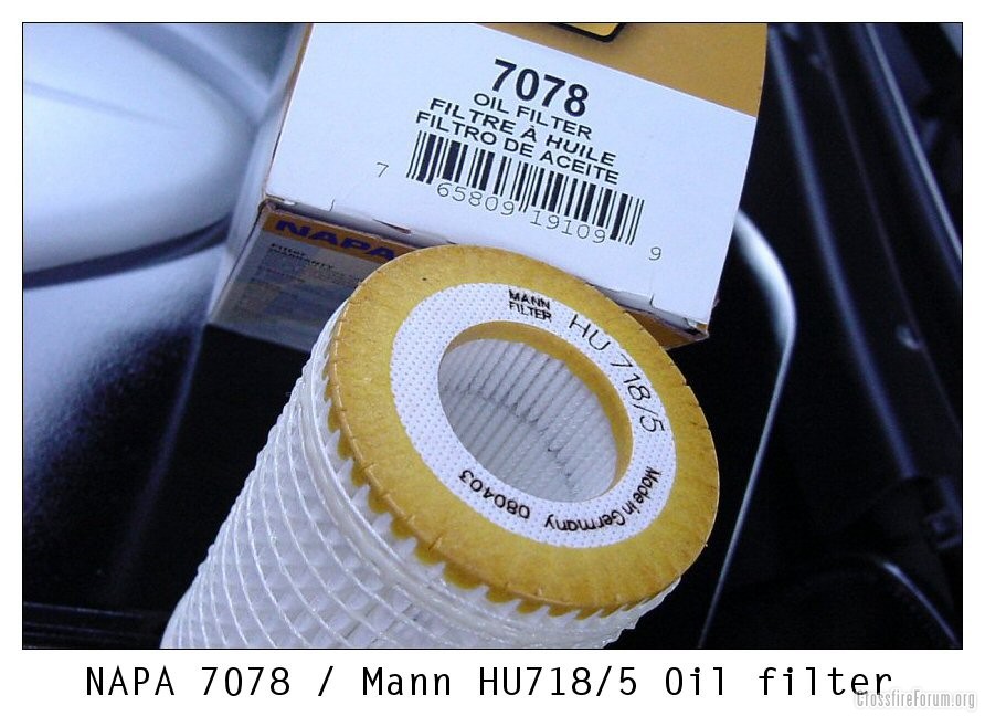

You should have opened the box to see what brand it really is. Maybe it is a Mann reboxed like Napa does?

I didn't think of that James, I will check it out next time I am there. As to your other point, if I go to Napa and ask for an oil filter for the car it will be a Mann in a Napa box?

If you go to NAPA and ask for the filter by application, you will get the paper designed filter(#1226). So you must ask for 7078 which is used for the Mercedes application and it is the fleece style. Also note that another member just recently bought several of these filters and one was made in Germany, and one made in China. So you have to know what you are buying.
