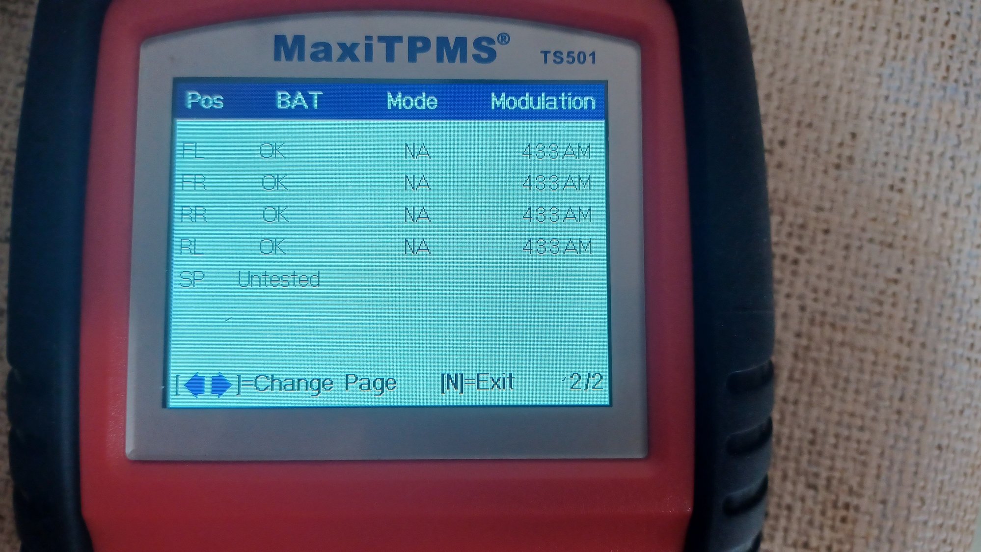

Default Re: help tpms
Here's the latest TPMS Relearn Results on my 2007 Coupe.
Status of TPMS wheel sensors on 2007 XFire Coupe.
TPMS wheel sensors info - Screen #1
TPMS wheel sensors info - Screen #2
An interesting fact that surfaced. The DS of my Coupe still has the factory OEM wheel sensors installed and they function fine. The PS wheel sensors both failed a couple of years back & I replaced them with VDO REDI-Sensors (SE100004A; 433 MHz). I set the air pressure in all 4 tires at 36 PSIG. The OEM sensors measure high; the VDO sensors measure low. But both are shown as fully functional & within tolerance.
The Autel also has a feature where it will check the status of the battery in the key fob. You set the scanner tool to the key test function, hold the fob near the scanner & press one of the fob buttons (lock or unlock). The scanner sees the signal & shows me how strong the battery is. Right now my wife' fob shows 48-51% power & tells me the signal triggers at 315 MHz.
Oh by the way, the Autel scanner tool came with the wheel magnet. Sorry for digressing.
Probably ought to put together a "sticky" thread where we can list Owners (dedwards0323) with locations (Upstate SC) that have the DRB3 Emulator w/Micropod 2 (or other TPMS capability). That way folks could reach out to a nearby Owner & get some help on performing the relearn process on the Crossfire TPMS system & clear the dash warning light.
