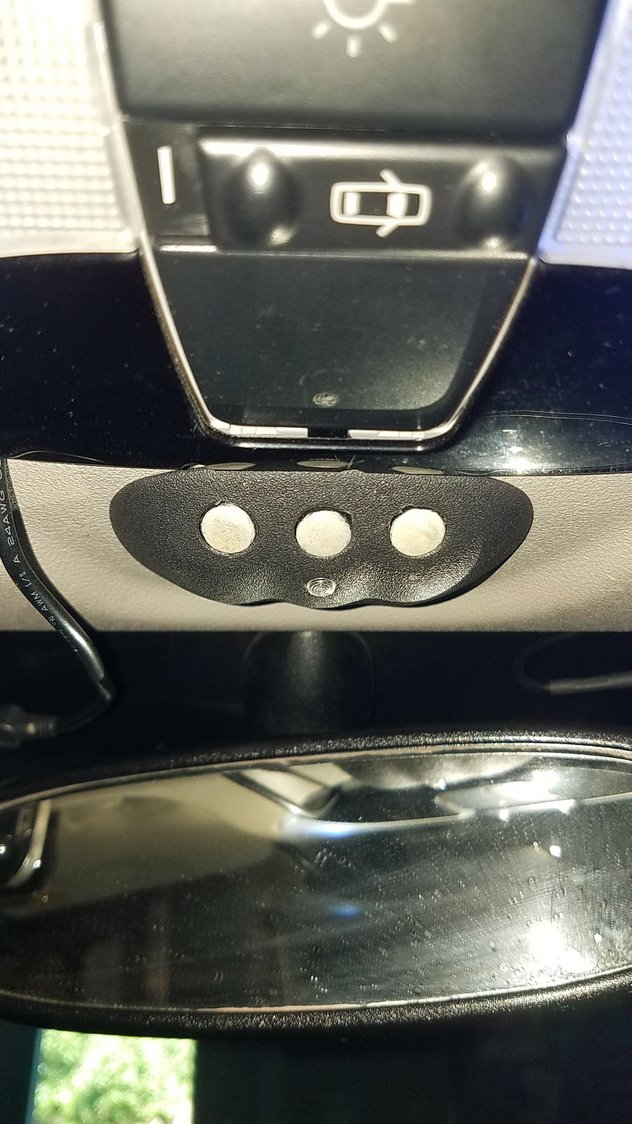

Call me a dummy, but I cant seem to find out how to ask a question about the buttons on the garage door opener on my 05 Limited. So I just posted in in the electronics section.
The three buttons are missing! Anyone know where to get them or even what they look like?
Thanks
