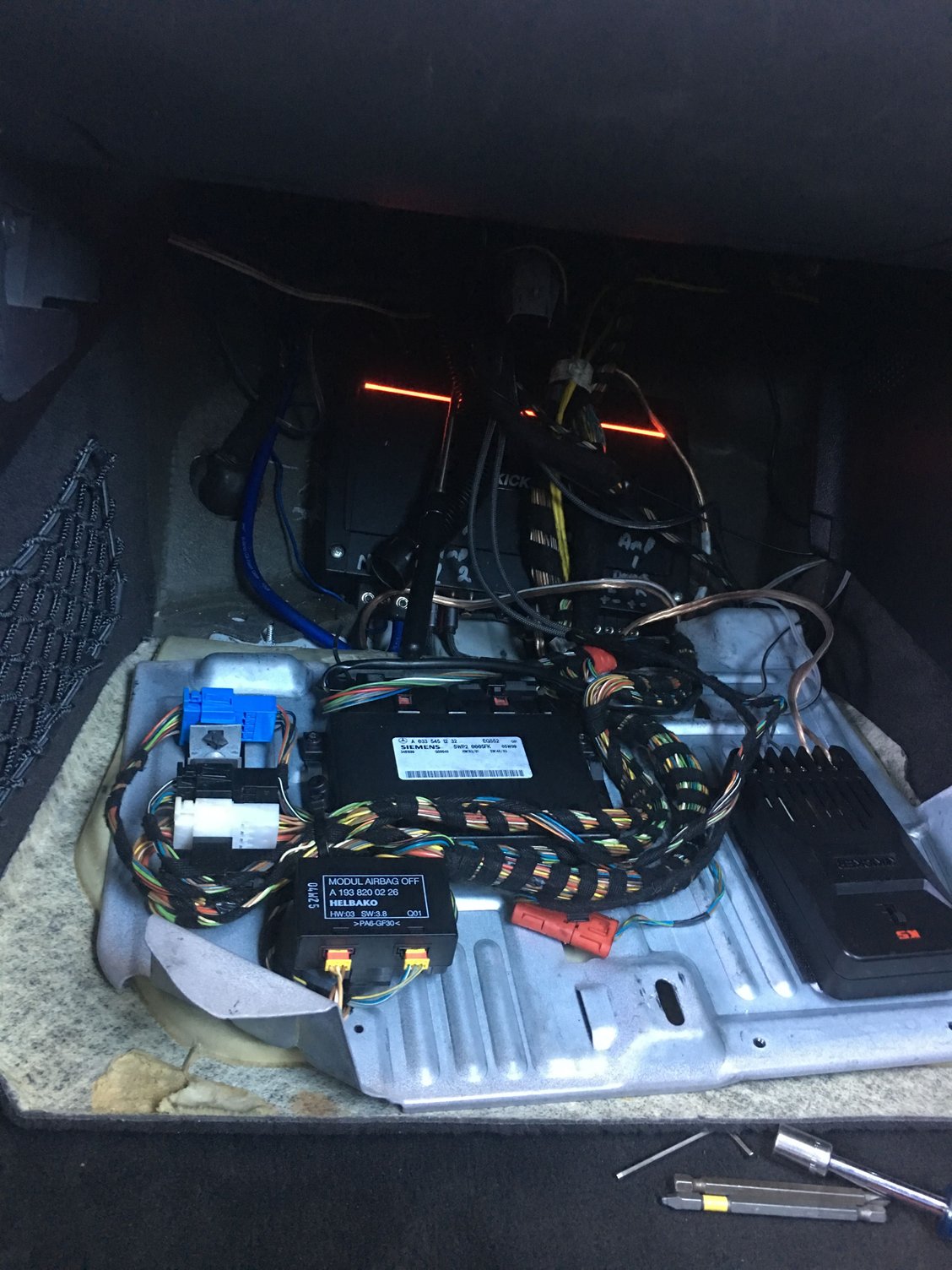

Hi, I'm new here and also new to the Crossfire community. I've always wanted a Crossfire but was never in a position to get one. I've just retired and found a 2004 Crossfire in excellent condition for a price I could afford and I snapped it up. The car rides like a dream and the only problem I have is with the sound system. The previous owner took out the Infinity radio and replaced it with a Pioneer DEH-X6800BS and when I turnit on all of the music appears to come out of the two speakers on the forward bottom corner of the car doors. I cannot hear any sound from the two small circular speakers above on the doors or the two sub-woofers behind the seats. This is making me very unhappy because I got the car to go on long cross-country drives while listening to the music I grew up with (late 50s through late 70s Rock&Roll). Question 1: Should I try to find the original Infinity radio (are they still available?) Question 2: should I try a different radio (Sony CDX-M9900?)
Also, I've heard that there is an amplifier in the car (under the floormats of the passenger side) that may be the problem; if so, is that unit still available from Chrysler?
Anything you can tell me to help this situation would be greatly appreciated.

WHo knows what was done when the aftermarket head was put in. I'd pull the head and look at the wiring back there. BUT, it could also be that debris under the wipers has clogged the drains and rain water has backed up and ran down behind the mat and ruined the amp.
In any event, you DO NOT want one of those factory amps any more than you want an OEM head. The sound system is not hard to upgrade. A new JVC or KENWOOD amp can be had for under $100, under $200 if you are demanding of a lot of power (which hte factory speakers barely can handle).
It would not be hard to buy an amp and new head and start over. My JVC head was $85 at Best Buy and it sounds WONDERFUL. I run mine without an ampl, my car is a Base with no rear speakers or amp.
I changed the head to hte JVC head, added rear speakers, and was happy for under $200 and about three hours of my time.
That's how Id do it, just start over. But seriously, pull the mat up and check for water under there. Don't let that go.

Lots of room in the passenger footwell for an aftermarket Amo
ditch the original
run the power to the Amp directly from the battery. There is a grommet beneath the battery tray. It will accept a 3/8” power cable

Mr. Pizzaguy: Thank you for your prompt replay. First of, I have to admit to not being at all familiar with the "lingo" used to discuss these problems. I'm confused between the meanings of such terms as "Heads" & "Amps". This is what I believe I know: 1. The "radio" itself does not directly connect to the speakers. 2. The "radio" has Line outputs that connect to the car's amplifier (under the mats on the passenger side). 3. The amplifier then distributes the "radio" line outputs (amplified) to all the car's 6 speakers (Highs/Mids & Subs). I had the installation checked by Bestbuy's Geek Squad and they told me those connections are alright. So, if my understanding of all this is correct, is your suggestion that I replace both the present radio as well as the present amplifier? and if I do that, that perhaps I also would benefit by replacing all 6 of the present speakers?
I sincerely apologize for my lack of education regarding car radio/amplifiers parlance but I never before had the opportunity to investigate/learn this stuff so I really do appreciate your help with my problems. Also, following your advice, I checked for water damage and found no signs of it anywhere but since I live in a very dry desert region it could be I'd have to wait for it to rain and go driving the car then. Are there other ways to verify the amplifier's present condition?
Thanks again for your help!
"Head" means "radio", I don't know why they use the term 'head'.
1) The radio drives the speakers directly in Base and SE models (those cars have no amps or speakers behind the seats.
2) WRONG -you'd think they would do it that way, but no. The factory 'head' (radio) drives the amp with it's speaker outputs.
... Most replacement 'heads' have line outputs as well as speaker outputs. It is best to drive the amp with speaker outputs. If you use "Line" outputs, they must be 4 volt level, if they are the 2 volt level, things won't sound right.
3) The system is wired oddly. THe factory head had only two channels, left and right. The output of the head feeds the amp, which is four channels. The harness is jumpered such that it operates like a two channel amp. If you put a new head in, you can wire it up so that each door's speakers are one channel and each rear speaker is one channnel, this gives you fade as well as balance control as well as separate equalizers for front and back if the new head supports that - most do.
The rear speakers are dual voice coil. I'd replace them with conventional single-voice coil models if you replace the factory amp.

If you have no water damage I STILL think the wiring is wrong. But there ARE a lot of our cars out there with bad speakers, and I do know some of our factory amps have failed on their own.
