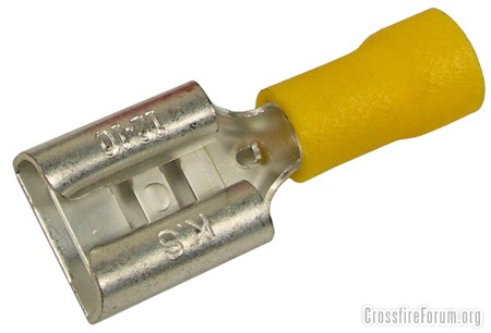

The female connectors inside that circled housing are common female spades.
Are you sure your NEG (-) connection is going to the lead with two (2) black wires?
