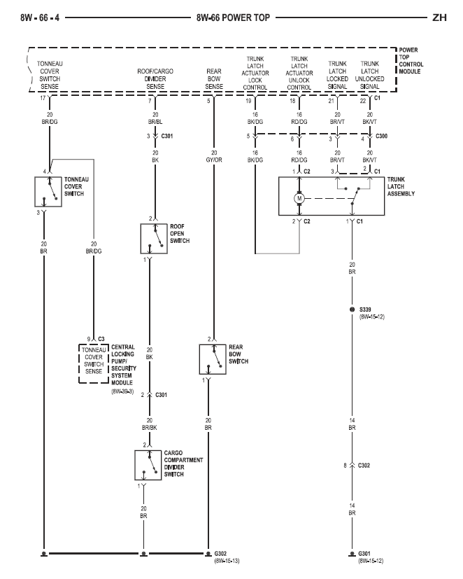

I am not sure if this is even possible or not, which is why I am asking the experts.
For the sensor in the trunk that allows the top to open/close when the storage hatch is in place, is it possible to add a bypass switch to this?
It may sound like a silly question, but I want to add a subwoofer in trunk and don't want the vibrations to knock the hatch or sensor out of place, stopping me from opening the trunk.
I would like to add some kind of override switch (or timed relay) to avoid issues.
Any ideas?
(Thanks in advance)

So... do you know if it is in anyway possible to override the sensor?

To override the partition sensor, just wire a switch across it and close the switch.
Don't blame me if you lower the top onto something crushable in the trunk
LOL, you mean I can't send you a bill for any damage I do by being stupid??
Seriously though...
I was thinking of adding a timed relay instead of a switch, which the button would bypass the sensor for 1 minute or so, that way I can't "forget" to switch it back to normal.
So, just a simple jumper will work, no need for any specific resistance or anything?
(Oh, and thanks ala_xfire)

I have jumpered that switch several times on various cars to get the top to work.
You can also jumper the 'roof opened' switch, which is in series with this one.
