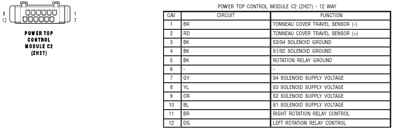

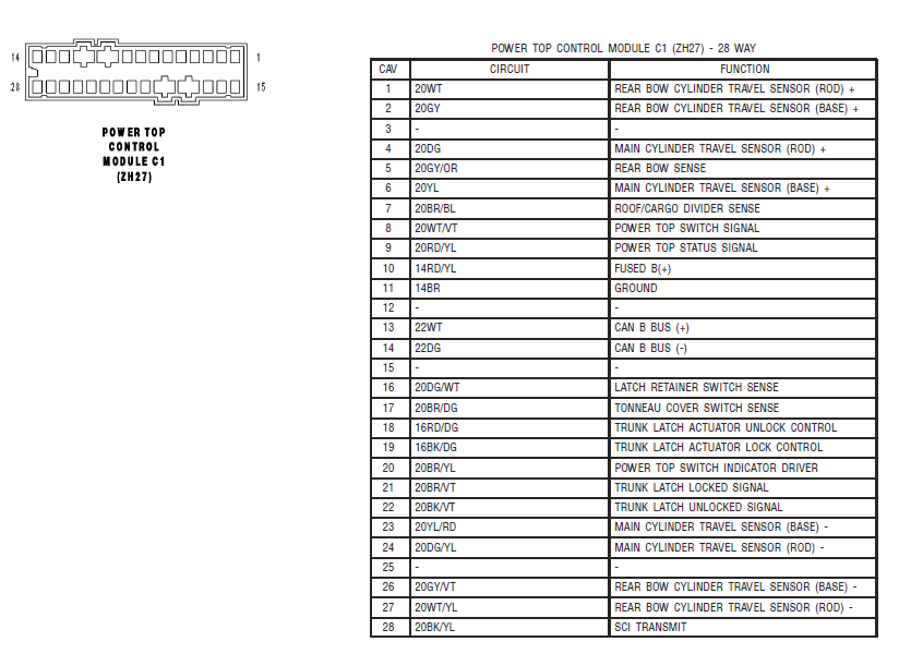

Um, anyone got a diagram of the PTCM pinouts? Trying to figure out which one is the feed from the Header Latch Switch...
Old Jan 18, 2021 | 05:01 PM
Default Re: What else should I check before ordering a replacement Header Latch Switch?
Old Jan 18, 2021 | 05:22 PM
