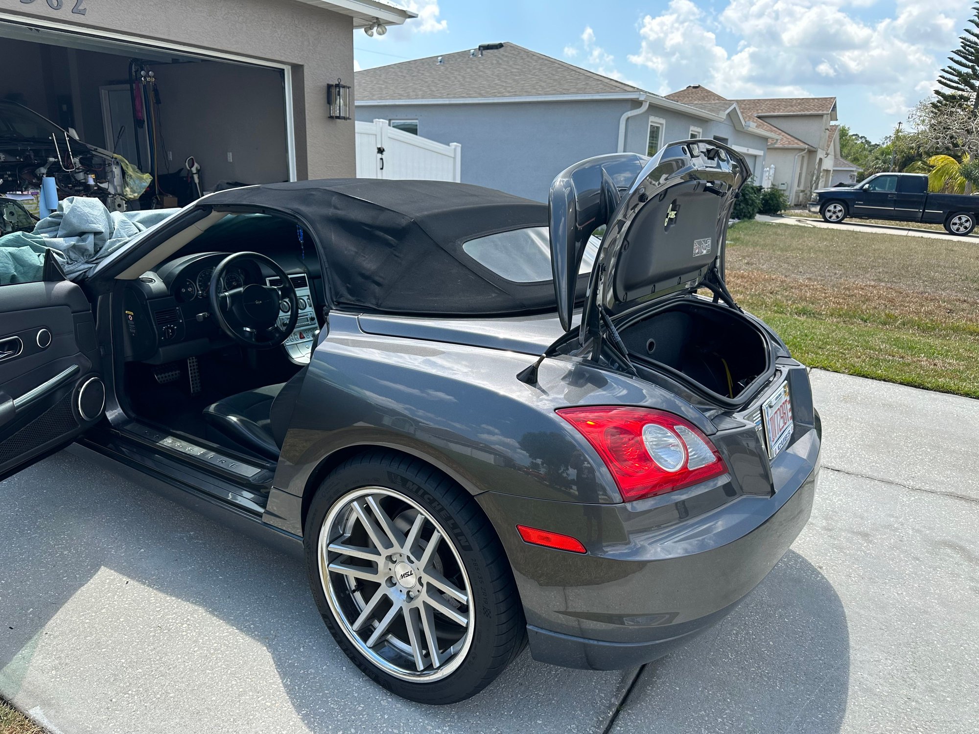

So, I have a 2005 Crossfire SRT6 Roadster I have just purchased… seller decided informing me that the hydraulic cylinders leaking was not something wrong with car… “cars mint, just a cheap, cloudy, plastic rear window, only thing that you may want to replace”…. Turns out they had gushing cylinders, that they stuffed with like a full roll of paper towels… anyways, so… I purchased a new top, figured I’d remove old, get to those cylinders, remove them, & send in to have rebuilt. Well… it started drizzling while in process of removing cylinders, so I tossed my car cover on quick, apparently the cover caught the rear bow & pulled it down, locking it down… except it didn’t fully lock, it’s half in & half out.. but I can’t hinge it to finish my job! The trunk will not open, I’m assuming part of a safety feature or sensors… because the rear bow latch is not 100% engaged/lock position? I have the tool to manually open top… but need ti be able ti get into the trunk, to use it 😬 the open/close button for top obviously is not going to work since I had already removed the left & right main cylinders… is there any other way to pop trunk open?! Or is that rear bow being partially down/engaged.. triggering a sensor that is no matter what, going to keep that trunk closed?

Awesome, thanks! I’ll definitely check that link out. I’ve been searching & searching… even on here, but I just kept coming across scenarios in which people had an actual lock issues itself. I sorta assumed there was some sorta I’d security or sensors when I couldn’t put the top down while trunk was open… so I had a feeling, I probably wouldn’t also be able to open trunk while changing out cylinders…. So I was making sure
not to close that rear bow… stupid car cover apparently got caught & pulled it down though… I wasn’t careful enough… or thinking much in the moment, other than… “I gotta cover this thing quick”. 😂
