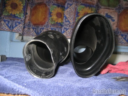

Could someone with a NW remove the grill and filter and take a picture - I've not seen anything like that posted on the forum. I thought there was a big silcone 90 deg going through the opening. It's plenty big enough for one.
Here's a pic of the same opening on my SL55 intake - it's huge (I can fit my arm up to the elbow thru there) but reduces down to the 3" intake tube. - Best part is I have a similar 3" intake tube on the drivers side. (Would that make it a 6" intake?)
So thats what you guys are doing who run the sl55 passenger side intake tube, its just kinda squashed in there?
Are you are running the other tube on the passenger side through the core support? Its even more tiny. If so any pics?
It's not squashed. Thats the size and form of the stock SL55 intake tubes, it just slides in there nice and neat - no modifications required.
For the other side I used a heat gun and formed the plastic opening to fit. I plan on using Steve Helliums idea of a 3" radiator type hose to fit thru the opening and then slide the plastic intake tube onto it. I think that will end up being a little cleaner.
That' why I feel there is plenty of room to run a huge silicone 90 thrugh the opening and why NW decided on only one intake tube - the other opening is a bit smaller.
Stock SRT Intake Tube & SL55 Intake Tube

Brian, Thanks. I am working on my SL55 intake now and will go get some 3" radiator hose for the driver side.

The driver side hole is REALLY small. I still think it would be trick to see someone with an aftermarket radiator thats about 1-2 inches thinner on each side, allowing for a true 3" dual intake that passes through both sides and remains a perfect circle
I was able to get a 2&1/2" OD, 2&1/4" ID hose through that hole, but it was tight. With a little trimming you could probably go bigger.
