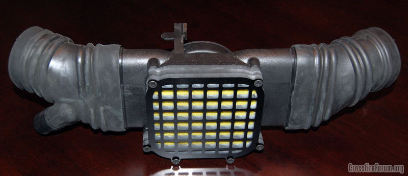

I thought the C3P intake image had already been added here, but I guess it hasn't. Here's a link from SRT-6 Dan's gallery:
It provides another way to suck in air along with the regular restrictive stock intake manifolds. It's warm air, but I guess warm air is better than no air. It's definitely nice to have a few different intake designs, though.

Originally Posted by Voyager
wait cant that just be added to the stock y? sorry im a thousand miles away from my car right now to see if it looks like i can. what im asking is can you run both that and the stock intake
This is the stock Y. You do run this and the factory filters together. The Code 3 Intake screws into your factory Y as shown in the picture.
oh ok. i was unaware of that. thanks!
No problem
