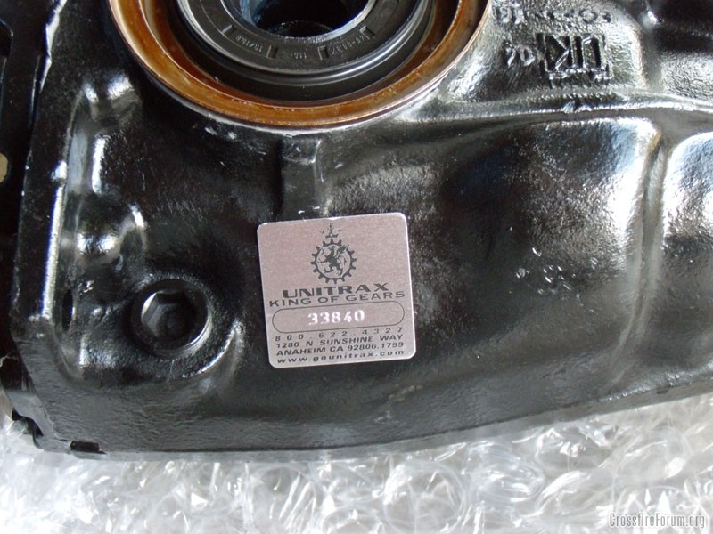

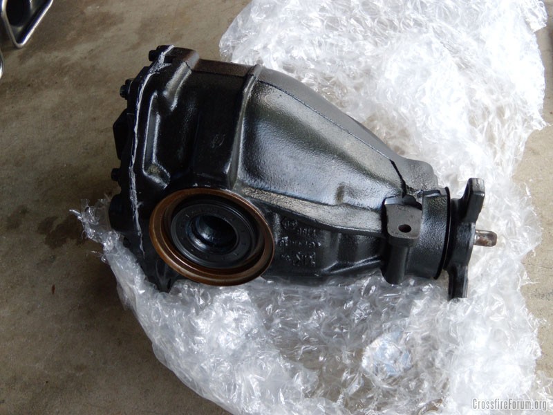

Here is how mine was packed coming from Unitrax... it came via FedEx and was in perfect condition to the box and contents.....
The main thing is to pack it tight so it dosent move and get loose. That is when things get damaged.
Old Jun 21, 2011 | 10:32 AM
  #876 (permalink)
MikeR's Avatar
Posts: 5,180
From: North Plains, OR
Default Re: *Needed* 20 to Pre-order Wavetrac LSD for SLK32/SRT-6
This is what was in the box.... it will be on the Aero by the end of today....
The old carrier was in a smaller box inside....this carrier only has 11k miles on it....
