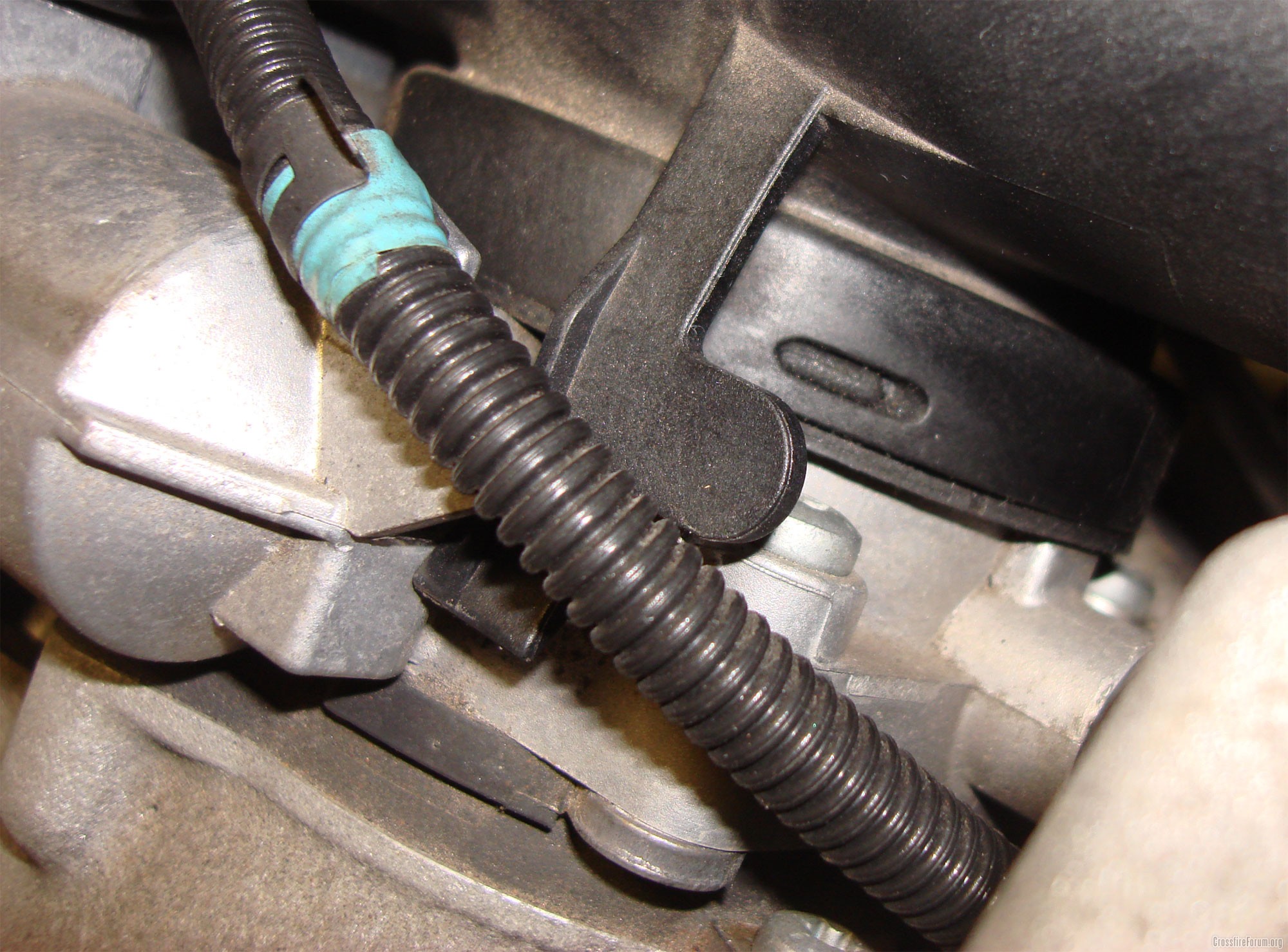

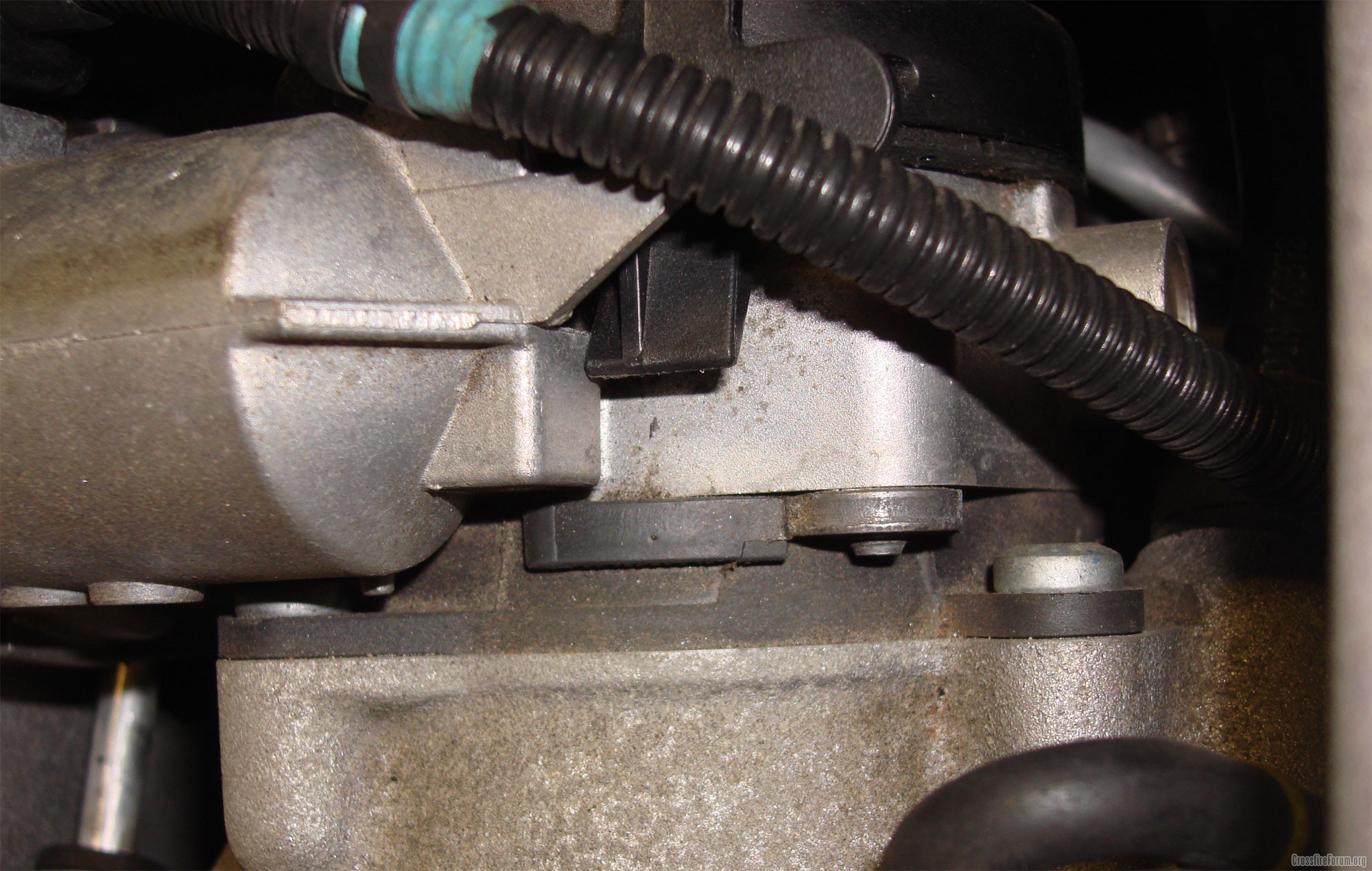

got some pictures
I hope these pictures are what you'all were talking about ...
first is some supercharger to gasket, looks fine in person, connection seems to be snug, no play:
below is picture of the whole assembly, the gasket from the wye looks and feels loose; one can wiggle the connection. Also appears to be a slight gap between gasket & wye (as shown in picture) but not sure if that is a real problem.

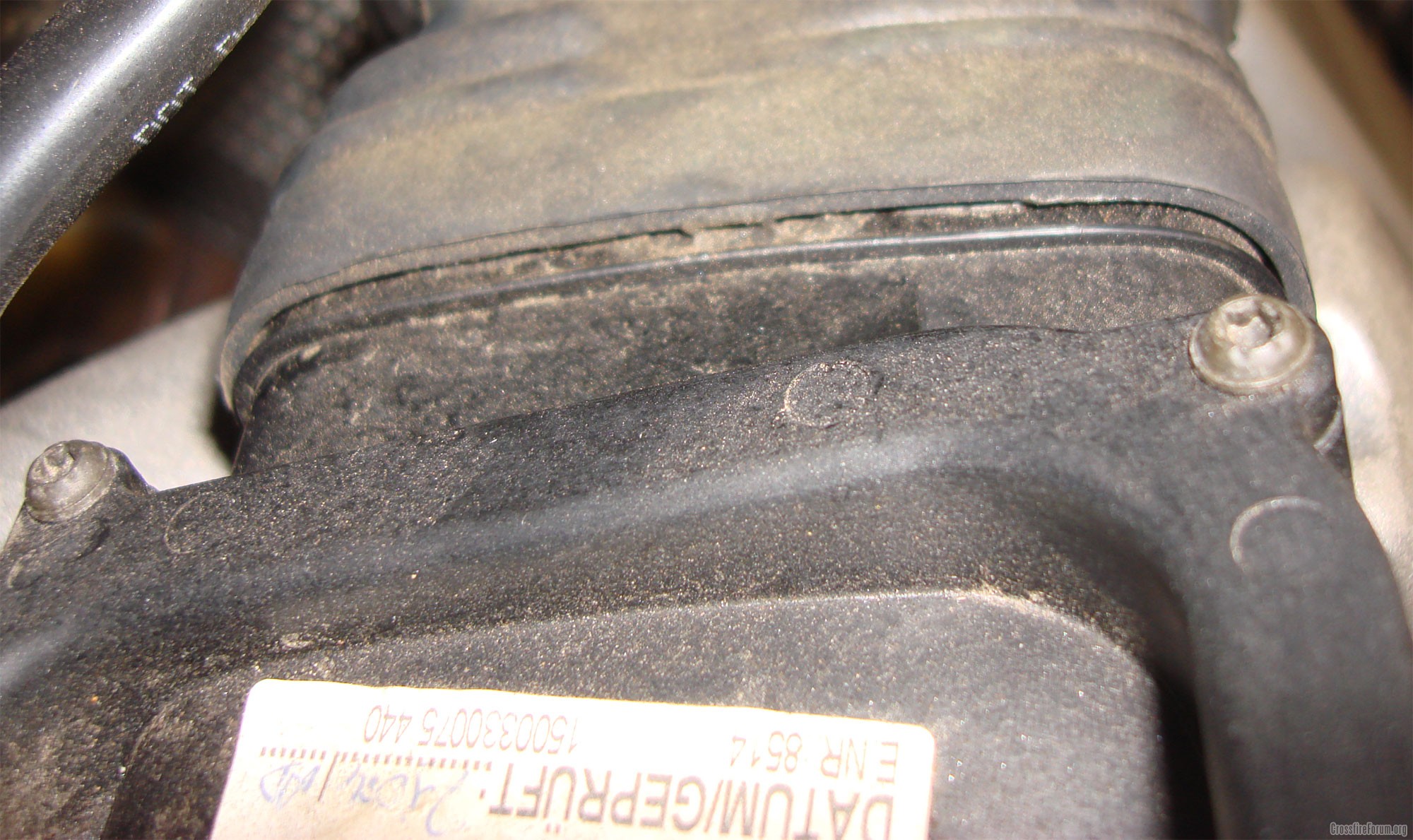

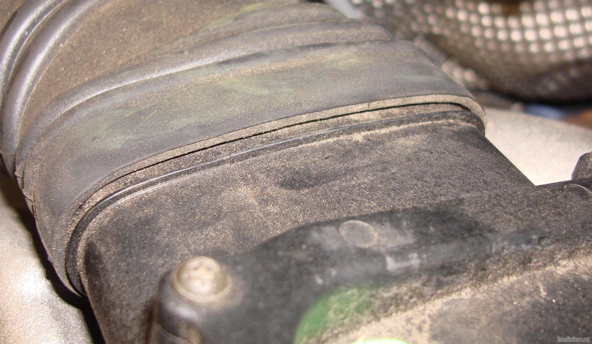

also got some pictures of the other end of the wye, both left & right, respectively.
looks worse in the photo, but there does seem to be a gap. Seems to emit sound. I don't have starter fluid spray. I guess I can try a plastic bag, see if it starts to suck itself in... giggity.

Old Nov 23, 2011 | 05:04 AM
waldig's Avatar
Posts: 4,508
Likes: 34
From: VA
Talking Re: hiccup | hesitation | slip
Stress and shaking on the TB causes the rubber spacer to split. I used crazy glue on the part after I washed it in acetone and it worked for me. I have been playing with all the intake changes and did not want to buy a stupid spacer if I could avoid it all.

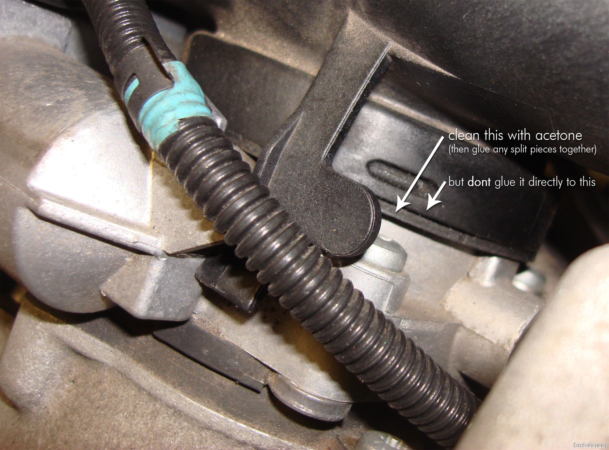

I want to confirm what component gets cleaned & glued. It's below:
I essence, that spacer is cleaned then glue any rips, splits or tears back together as not to required the purchase of another spacer?

Old Nov 23, 2011 | 10:03 AM
MikeR's Avatar
Posts: 5,180
From: North Plains, OR
Default Re: hiccup | hesitation | slip
the best way to check that gasket is to take it off so you and pull on the two plates.....or at least take the TB off.... 4 screws... then you can clean it and glue gasket if you like.....you can also clean the TB while you have it off.
You can buy a new gasket from Chrysler dealer for ~$8 though....
