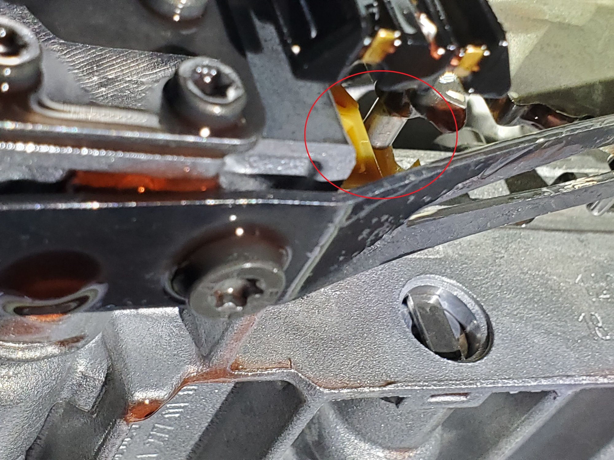

The connections have been checked. Thank you @zip439 and @oledoc2u for your suggestions. While I had leakage around the electrical connector, I think the O ring around the connector needed replacement. So I think I have root caused the issue. I think the plastic part to the selector valve is broken.
I found this in the bottom of the transmission pan. I have cleaned it up and placed the plastic part back where I found it:
broken plastic bit that should not be there
Look in the circle

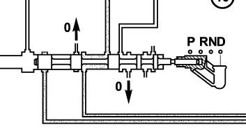

The beige plastic bit is the selector valve. The selector valve is what tells the system to activate.
Selector Valve chooses P, R, N, and D for Drive

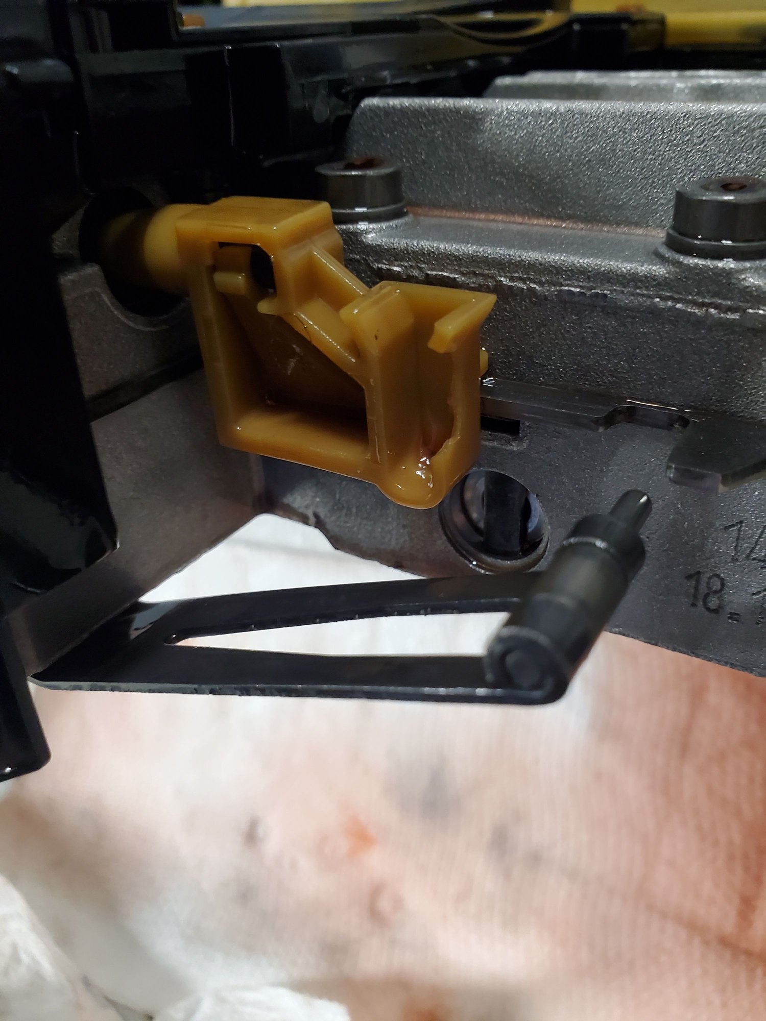

I finally removed the valve body to see about rebuild or replacement. For some reason the selection lever broke and caused my transmission to no longer shift into gear.
The missing chip is on the right hand side
