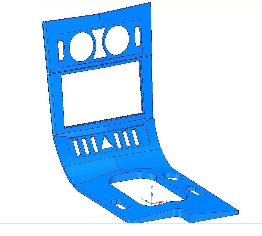

NEW TEASER... Well I removed the logos, added the switch plate, and have taken the angles a little further (worked better with my software and I am rather pleased with the new look). I plan to do this in ABS, and this will have factory posts that I want to line up with the factory bezels. I decided it may be better to include the shifter bezel because of my OCD and not wanting to tear into the factory OEM bezels. The 12v cigarette lighter moved, but have not added the airbag light location yet (had been thinking about moving this into the glove box). I figured this would be easiest to be in 4 parts (HVAC/DoubleDin/Switches/Shifter). Between each of the parts will have subtle overhangs that will help lock this in place. Contemplating putting a retractable cup holder and/or cell/storage area. Still have much to do before adding more. I am also working on a sleek custom windscreen design and something to replace the pitiful rear bulkhead storage bag. Keep the feedback coming guys!
Second Chrysler Crossfire - Double Din - Rendering.

You have taken on a mammoth task, and I hope you keep at it. I see you have added a second design while I wrote this.
I have some experience with making a DD Radio/AC bezel, I modified OEM parts and needed two OEM R/AC bezels, an ash tray module and a centre console bezel to make my project, my switches were moved to the centre console. These parts cost more than I would have wanted but this method had the advantage of using the original mounting screws, tabs and any profile in the OEM interface. The switch mounting tabs have to be sturdy, the switches could be bonded in place of course but that may not be ideal.
An option for you may be to get one Rad/AC bezel which are made of two pieces bonded together, remove the rear part that carries the mounting tabs and screw holes and use it bonded to your part.
Your top two parts should be one part as all the mounting points are on them and the screw holes are on the radio part in your drawing. Your lower switch section should clip to the radio section and use the lower ash tray mounting screws. Ideally it should be one part for strength. A second centre dash would save you time in fitting.
The radio should not put any load on the bezel, it’s weight being taken up by the centre dash. The material you choose must take extremes of temperature to prevent distortion due to heat. The OEM parts are a Polycarbonate/ABS alloy that gives the best physical requirements.
I am planning on making a one piece bezel with the switches in the bottom like your design before I finish paint all the parts. I have to think it over for months before the first cut. Meanwhile I am making four bird feeders that were meant to be Xmas gifts, there is more work than I anticipated though, maybe gifts for next Xmas? ��

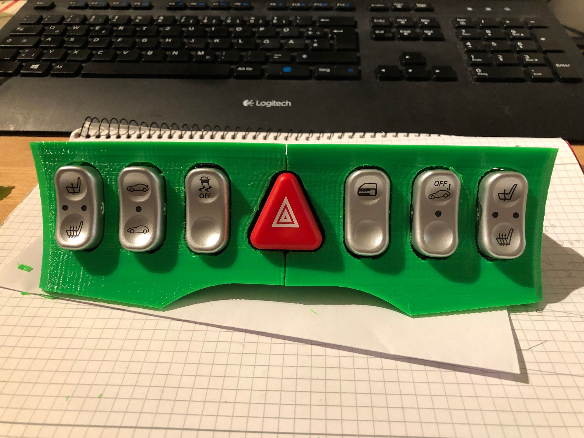

I started something similar to make a 3D printable button replacement for the ashtray, as that’s the hardest part in a double DIN mod in my opinion.
This is what I have so far. The original button bar will snap right into it (tested after 3D printing it). Maybe we could join forces?
Prototype of course lacks the paint and some details.

This is your bezel design. Your button section appears to be too short and too narrow. The length of the button section is determined by the heated seats buttons and these are the two outside buttons. Your actual button part is correct of course.
This is UrbanEs design below, your design appears to have some scale problemd to the actual parts.

Yes, I know the scale is off. I have been working on the overall, and will make the adjustments before prototype prints. My garage renovations were cut short since December 18 (haven't had a winter like this in the Midwest for 3+ years) and my car is being kept in a rented garage, so I haven't had direct access to all my bezels for exact measurements. This is really a mock photo.... My working model does not have the bevels and curves, this allows me to scale the design without the extra finishing bezels that can sometimes throw the design sizes when adjusting the major surface area of the bezels in my computer modeling software. I have already shortened the ash-tray curvature. The shifter bezel is no-where near exact, but easily customizable to be accurate. This is just the top surface, still will need to add all attachment pegs to hold the bezel to the actual console. I have really tried to keep the same ascetic as the original bezel, with the center spine basis of the whole car. I am not particularly fond of the Mercedes SLK bezels that are more recessed than the XF, and like the raised bezels with the tapered edges.
