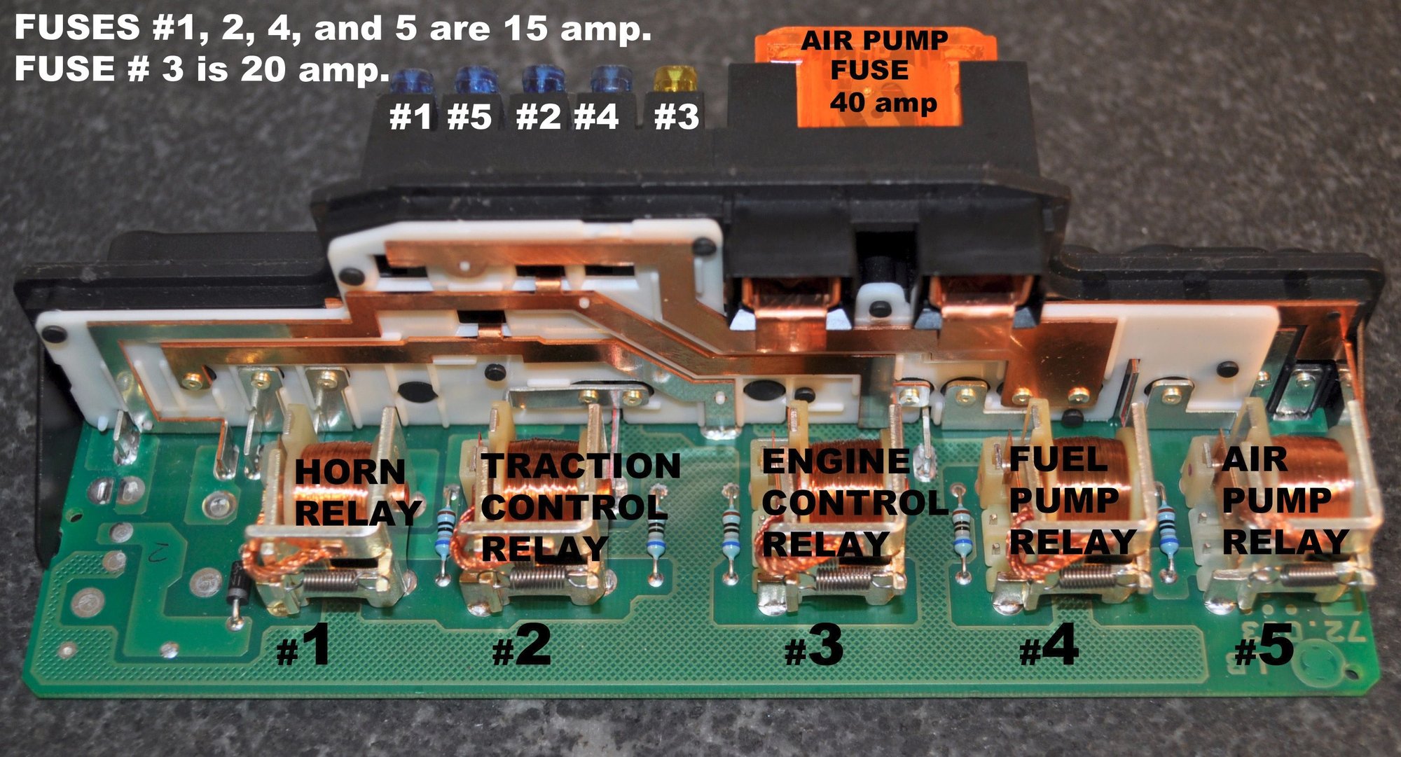

I assume you have checked all the RCM fuses.
Pull the RCM out leaving the 5 harness wires connected and remove the cover.
Turn the key on.
Make sure the engine and fuel relay are being energized.
Meter the contacts on the engine and fuel relays to see if the 12v is being passed through the contacts :

Traction control relay should be engaged also.
"Would not crank" points to the RCM.
Wing staying up points to the RCM.
Appears you have a couple of bad relays. I can replace them for $30 or you can buy a new RCM for about $150.

Well there you are. You have fire. Now turn the key on and within a few seconds depress the Schrader on the fuel rail. Do you get a squirt of gas ? If not then (am assuming from what you said earlier, the RCM has been gone through):
1) fuel pump
2) fuel filter
3) fuel line.
4) fuel pump relay & wiring
