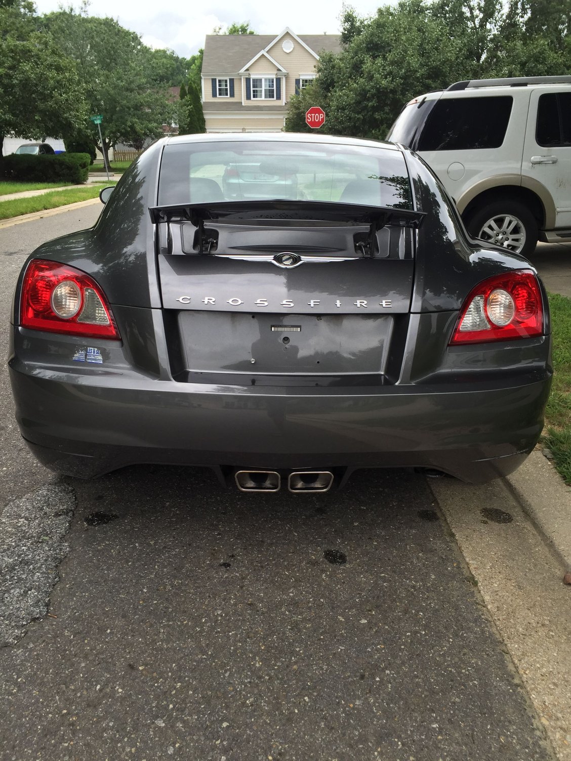

J​​​​so many people are terrified of Craigslist .. Not I. Found and bought this beauty (nick name Vicky but my friends call it the "space coupe" hence my username) for 4K flat from guy in Lancaster PA.
I live in Maryland and definitely have plans for the car moving forward into the future hope to keep you guys informed and and even answer some question possibly and get some as well.

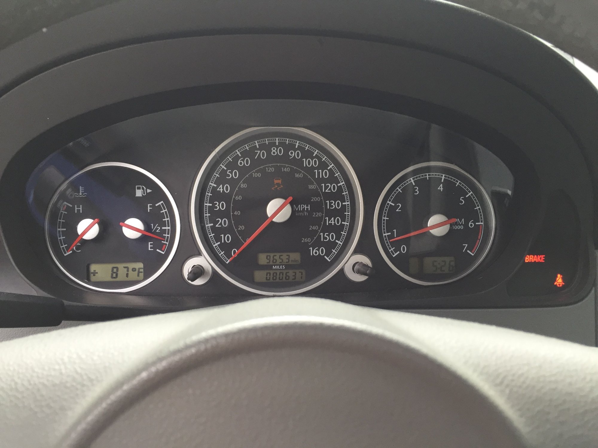

Just to prove i really bought it with 80k original miles 🙃

fyi: It's a 2004 limited MT with 80k miles on the clock
