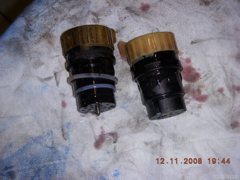

how bout you taking another look at the 3rd pic looks like a screw to me ,,,,,,the unit this pc conects to will have to be replaced is what there telling me

There's a bolt that holds the electric adapter onto the connector plate that is located above the "valve" body (not throttle).
The connector has to come out before you can drop the connector plate that is connected to the valve body.
My guess is they jacked it up or the bolt is already loose and they just haven't tugged hard enough on the connector to get it out.

Ok. they are talking about the connector plate. I had to replace mine cuz I jacked up the pins.

The outer ring of the adapter twists to release the electrical connector from the car. You then loosen the bolt and pull (can be stuck) the entire connector out.

It looks like a screw if you know its a screw, I enlarged the photo and you can just make out threads, if you know they are threads.

The first connector is dirty and old, it has a male threaded fastener.
The second clean connector is female, which means that the male pin unscrewed from the connector shell and not the connector. They are doing it and if its a TSB, go for it, but otherwise Id go with the northamericans idea. However they (dealer) do in their shop their way and wishing it otherwise is a bit late at this time, so you may go with the flow.
Me Id rip it out and go without and use the twist lock to hold the whole mess together. Woody

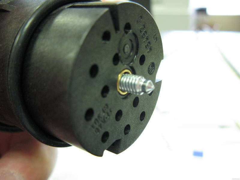

Dudes. The plug pictured above "screws" into this connector.
The plug in turn "grabs" the wire harness when you spin the outer collar on the plug. I don't think the entire assembly would hold by just spinning the collar. Unless the collar actually locks onto the trans housing. Don't remember.
I could be wrong. It's been awhile since I played with this particular area.

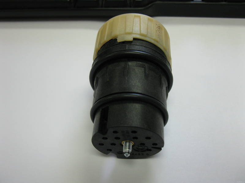

Found a good pic of the plug and the connector (plug). The one on the left goes inside the one on the right. The threaded area at the top of left plug is what the white collar on the right locks into. So these two plugs will be held together. But the entire assembly still needs a way to connect to the trans.
Looks like yer gonna have ta put some sort of screw/bolt in there to hold it all in there.

I wonder if just pulling on the plug while turning the screw would let it back out,,,and again it may already be loose and just need to be pulled on harder....., really nice pics Mike thanks ,,,makes it easier to see what i'm dealing with ,,,,,where can i get the blue top solenoids if I decied to let go that route,?

picked up the adapter at lunch from dealer this should just pull straight out and adding pulling presure should let the screw back out ,,,I think the dealer was trying to give me a bath ,,
