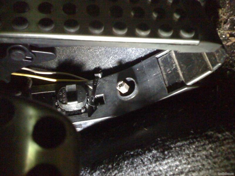

I can pull the pedal in about 1 minute. I trashed the nut and washer and added a stud nut. Its taller and when loose you turn it by hand. There is one of my threads on it and Ill try to find it for you. Woody
https://www.crossfireforum.org/forum...last-time.html
https://www.crossfireforum.org/galle...072010_136.jpg

Ok, I got the little bugger off with a 13 mm socket with a little crazy glue on the rim. This was my first method but I was using a tired tube of glue and a 10mm socket so it didn't work. You have to hold the 10mm in place, the 13mm fits snug.
Next question. How does the top of the pedal unhook? Thanks
P.S. The above washer removal method has to be the easiest way available. Just put a really small amount of super glue on the rim of the socket. Lower it in, wait a while and pull it out.

Wiggle the top as you are pulling out. It has a post that sits in a hole.
INSTALL PHOTOS compliments of PAULW
Option 1
You need to remove the throttle pedal following step below:
1. Remove the lower nut cap.
2. Remove the 10mm nut.
3. Remove the washer, a magnet helps.
4. Remove the pedal, lift the bottom pulling out and pull it out of the upper bracket.
5. Unplug the tps cable from the sensor.
6. Plug the tps cable into the Sprint Booster.
7. Plug the Sprint Booster cable into the tps sensor.
8. Reinstall the pedal assembly.
9. Go for a test drive, you WILL SMILE !!!
Option 2
Remove the kick panel on the console. This is the panel that is to the right of your foot as you sit in the car. First remove the screw on the side of the console where the vent is. After that is removed remove the second Phillips screw holding the side panel on the console in place. Remove the drivers side of the console. Now look back above the gas pedal and there is the plug. Squeeze the sides to release the locking mechanism on the plug. Unplug and insert the SB. Replug the plugs with the SB in line. Replace console side and screw and then the vent and screw and now you are done! No pedal removal or nut to drive you nuts. Simple.
