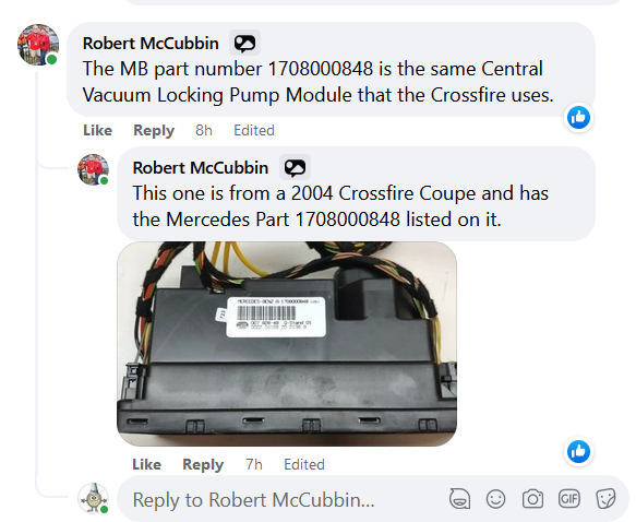

Do you know if a Mercedes CLP/SSM (Central Locking Pump, Security System Module) P/N 17080000848 fit crossfire P/N is 5102774AA?

The Crossfire part is 170 800 08 48 and does not start with a 193 xxx xx xx .

Verdict is: "The Crossfire pump is unique to the Crossfire, I would stick with a pump from a Crossfire".
Which is what I suspected he'd say. I would also caution you that the brains of the CLP/SSM likely have model-specific code not compatible with other models.

Here is the Crossfire CLP/SSM
It is 170 800 08 48
As you can see it is not specific to the Crossfire. It fits the coupe and roadster.

OK, Robert McCubbin thinks differently.
It is 170 800 08 48
When I said "model" I meant Crossfire versus SLK320 - and even then, I appear to be wrong.
I KNOW the Coupe and Roadster use the same one - that was proven years ago to my satisfaction, Dave.
