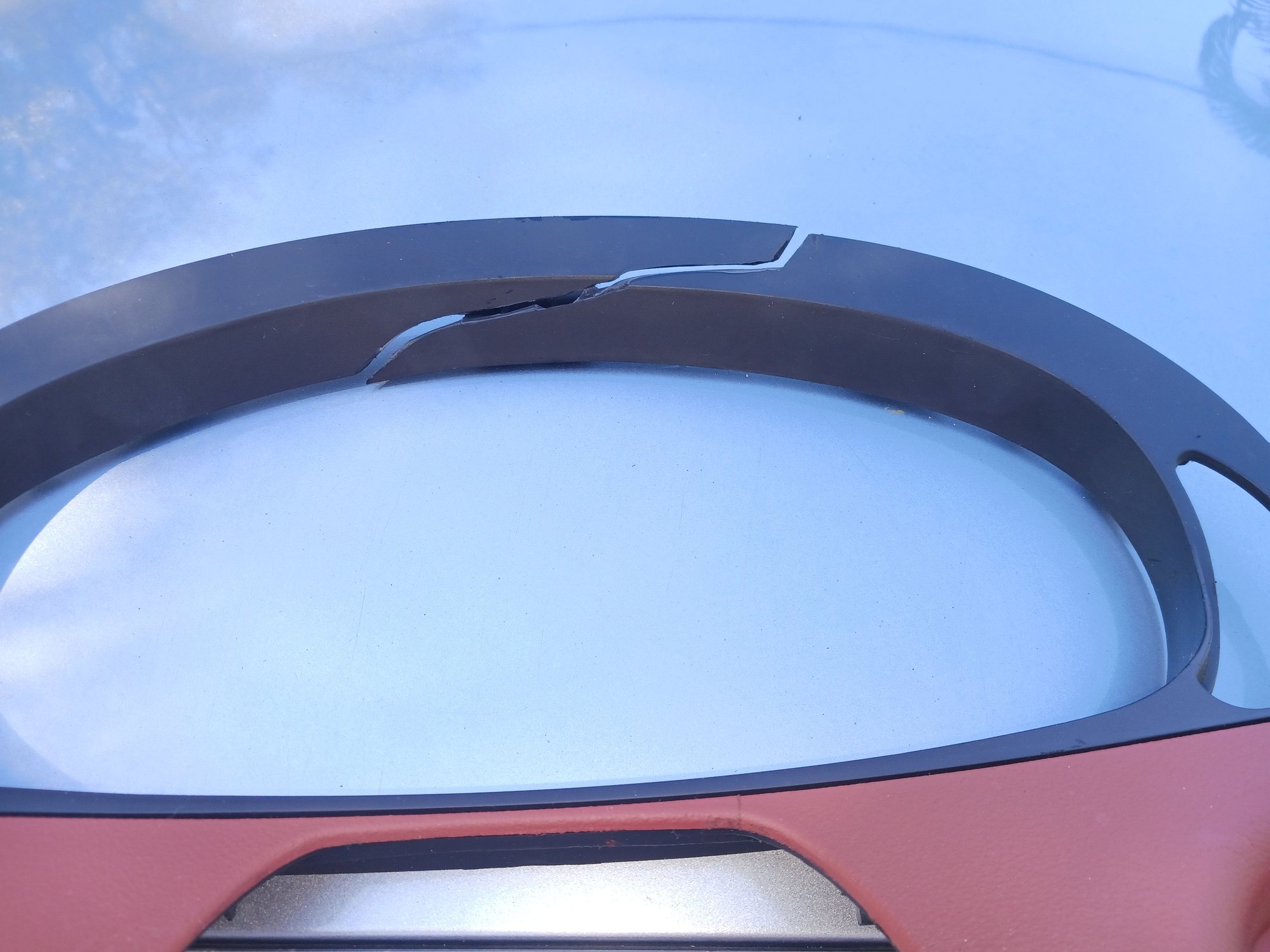

HOW THE HECK DO YOU GET THE DARN BEZEL BACK ONTO THE GAGES???? When I removed the bezel I broke it at the top and had to epoxy it back together. I don't want to manhandle it, but for the life of me I can't figure out how to reinstall it. Any help would be greatly appreciated.

Oh yes! That's what I needed. Thanks for that video link. I'll bet when i start doing the "bending" to get the top in it breaks. I'm thinking maybe to cut off the two lugs at the top so I don't have to bend it so far. If it seems a little loose I could put a dab of silicone adhesive there. I saw a used bezel for $175 and I though "no thank you!"
I used a soldering iron, on the backside. to melt pieces together before using the ABS plastic epoxy.

Everything is back together except for the two screws at very back that secures the foot guard. Just can't find the alignment for the screws to grab. After cutting off the tabs at the top of the bezel, and breaking two tabs left and right of it, the bezel went right on and seems to be tight. The bezel tabs are very brittle from the age of the car. (Thanks eelya1 for link to the how to install video!)

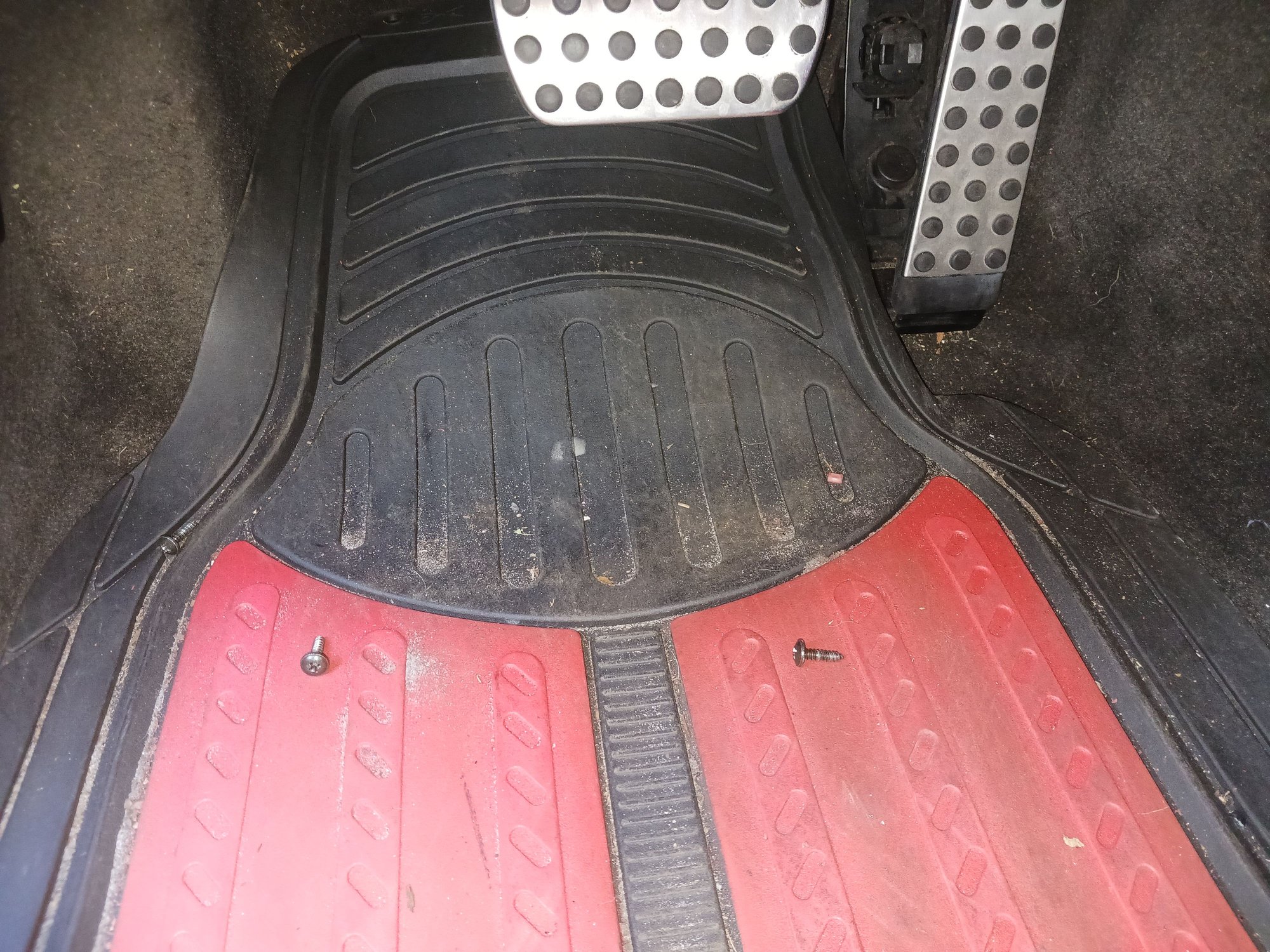

You said, "Everything is back together except for the two screws at very back that secures the foot guard. Just can't find the alignment for the screws to grab."
One of the Sticky Key tutorials advised against removing those two screws for that very reason.
I didn't remember that though, and also removed them.
Luckily i was able to get them back in.
Old Jan 9, 2023 | 03:50 PM
If I don't eventually get them back in I'll use some double sided carpet tape and stick that sucker together. LoL With the multitude of "Sticky's" how did you find that little tid-bit of information? Thanks eelya1
