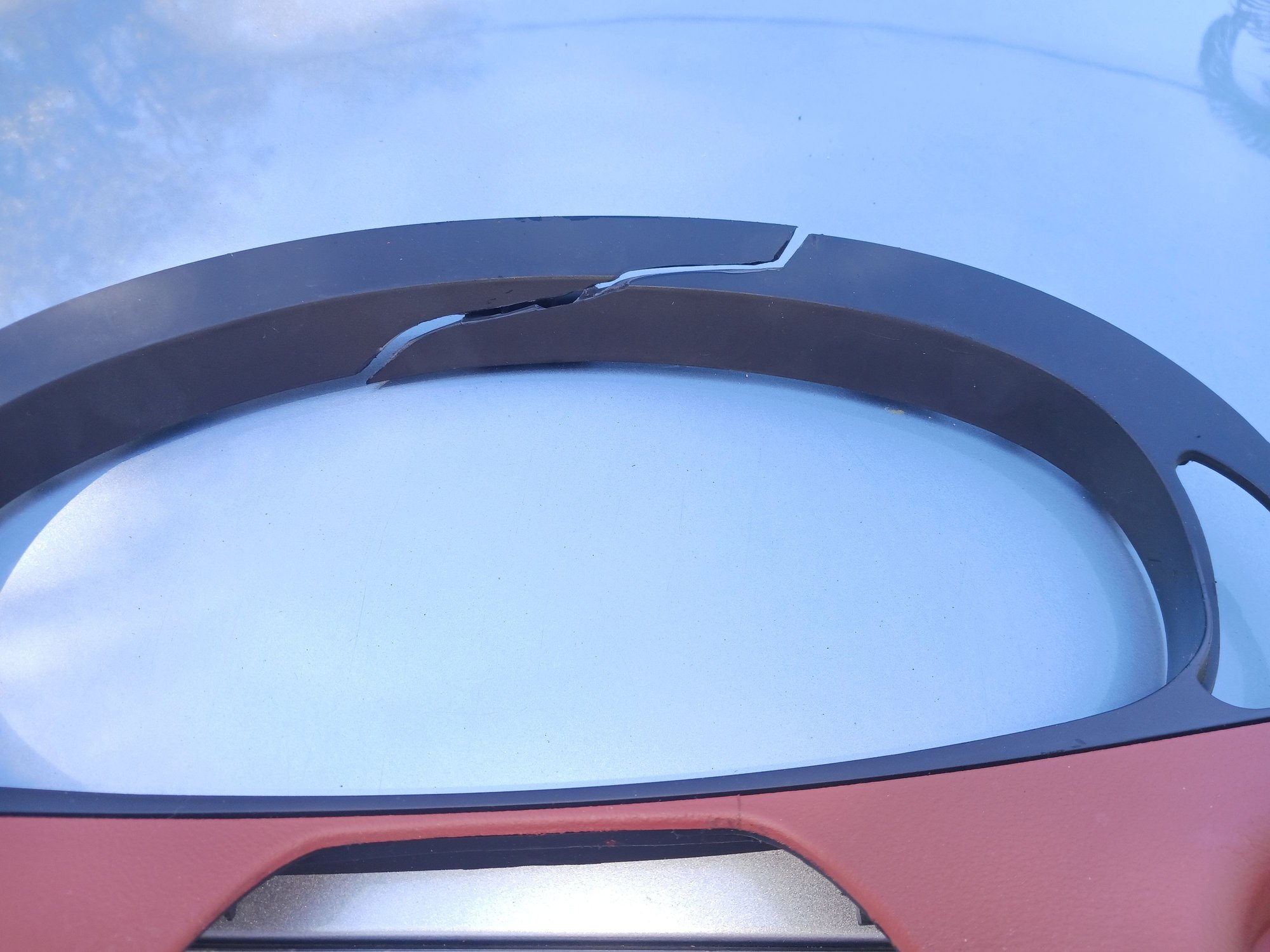

Yes all the wiring came off even though the back was a little tough. I took the spider trap door off and nothing was inside. Looks like there never was anything inside from the factory. I put the switch assembly back in and it starts just fine and the key comes out every time with no problem. (This time! LoL) Now I have to do some dash tupper ware fixing. The dash ring broke when magilla gorilla tried delicately to remove it. Also I noticed several other broken places that will need ABS plastic epoxy as well. That's why I notices a lot of play in the dash and lower parts.

I hate to tell you this but the cluster bezel did not to be removed only the lower dash. Your best bet is to try to find a used one and if you can't find a red one then try to match the paint. They are super hard to put back on.

With the key stuck in the switch I could not manage to remove the assembly as the key was hitting the bezel. Anyway I'll leave the bezel off for now because I will remove the SKREEM module should I have no start problems in the short term. I'm pretty sure I can paste the bezel back together and not be too noticeable. Two of the attachment lugs are broken as well as a 3" piece on the backside. I only want to reinstall it back "once" should I have the SKREEM repaired.
