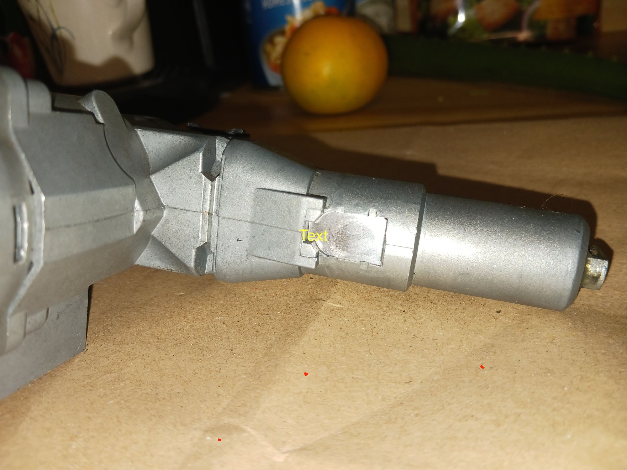

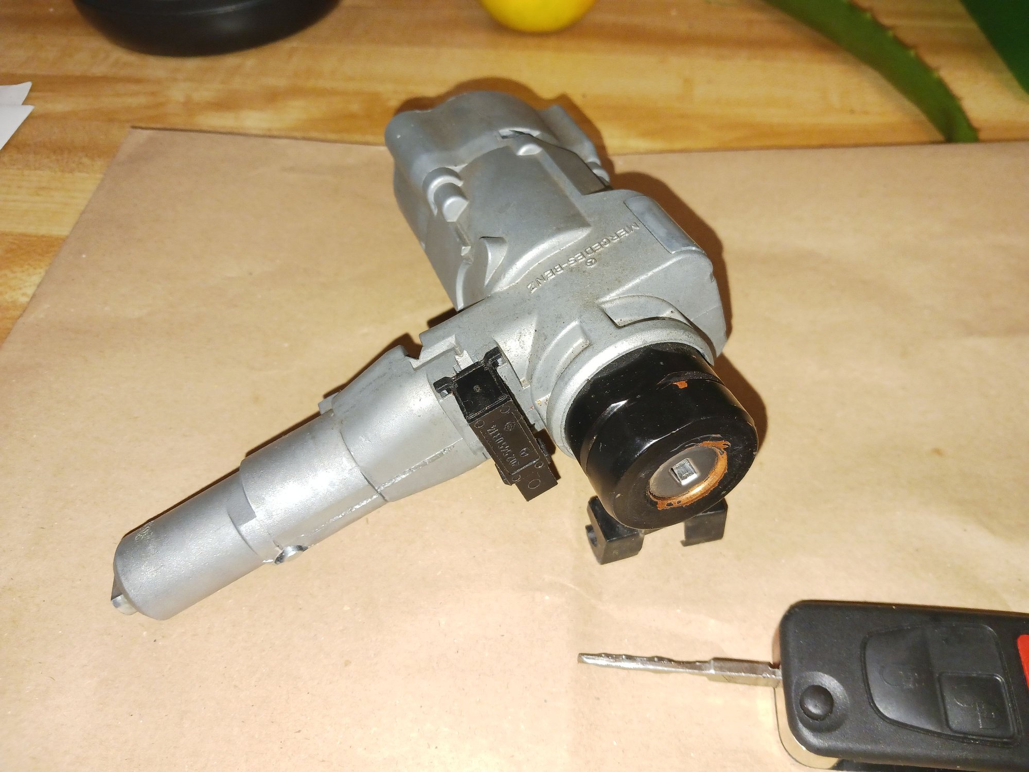

I was able to remove the column locking assembly. When I tried removing the FOB antenna ring it would not pass over the stuck key. I fumbled around with it and the tumbler locking nut, below the antenna, moved and the key fell out into my hand!!! So my question is what is the fix to keep this from happening again. Should I remove the spring and pin under the little trap door?
Update: Looks like the tumbler locking nut had nothing to do with the key coming out.
Update: There was no pin or spring under the trap door. Looks like it came from factory that way!
Side note: Installed new seat relay, while I could get at it, and the seat works again.

With the lock assembly removed I can't get it to duplicate the key stuck in the lock problem! Anyone know if this is faulty tumblers in the lock? Would dry lock lubricant be advisable?

The antenna ring pops on and can move a little bit. It is attached to the skreem. If you glue it on there then you will have to break it off later. I think Mercedes still sells them. When it comes to ignition switch situation, yes finish performing the sticky key fix so this doesn't happen again.

I now don't think the black tumbler locking nut had anything to do with the key being stuck inside the lock. Can't get it to get stuck again! Maybe one of the tumblers doesn't retract all the way and causing the key to get stuck. WHAT NOW TO DO????? Put it back together and hope it doesn't happen again?!?!

Dude, you won the lottery that were able to get the key out, most of the time people never get it out again until they start drilling! Remove that pin and you will never have that problem again, there is nothing wrong with the tumblers. Do exactly what is listed in the sticky key fix.
