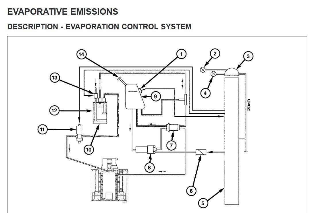

Get in the service manual, go to Chapter 25 "Emissions Control", then go to "Evaporative Emissions" in that chapter.
IGNORE the parts on the EGR and crankcase ventilation. Concentrate on the EVAP diagram, this is the system that is failing the test, if, indeed, it is really failing (keep reading).

The pressure in the tank during the EVAP test is measured by a sensor in the middle top of the tank. It's easy to see it in a Roadster.
There are two sensors, one for fuel level (has two wires) and one for tank pressure during the test (has three wires). You are looking at the level on the wire in cavity 1.
