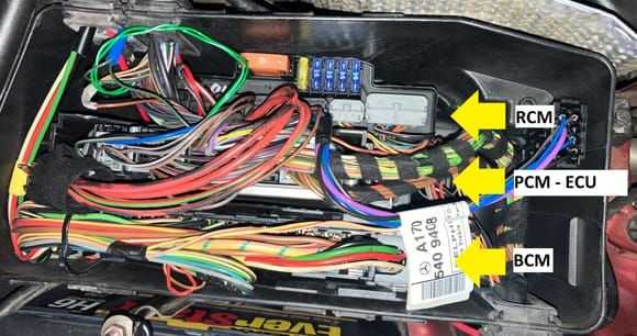

I'll take a guess the traction control relay on the Relay Control Module (RCM) is going bad. This is a common problem.
There are a number of DIY easy things to try, but with you not being able to work on the car and it being in a shop they seem out of the question.
I would hope the shop the car is in could use a scan tool that can get into the Mercedes specific codes as that may help get you started in the right direction. For your own info click on this link to get you headed to a possible solution. The post talks about resoldering some cracked joints, but in your case you want to replace the entire RCM with a new one and/or send the one that is in the car to tighed1 for repairs Myster No Start

I would simply order a new RCM and plug it in, you can change it without tools. THen, send the old one to DJ for reworking and carry it as a spare. That's what I did.
1) Order this:
https://www.autohausaz.com/pn/144017...LYKUfdOA7753tY
(Their web site will tell you it does not fit the Crossfire - ignore that.)
2) It sounds like you replaced the battery, if not, do it NOW. Then, make sure battery cable clamps are clean and tight.
3) Then do James' mod as described here:
https://www.crossfireforum.org/forum...le-engine.html
These are all relativity inexpensive things to do that many of us have already done. See where you stand after this, if issues persist, let us know.
Again, the RCM can be changed by ANYONE without tools, it's in the box next to the battery. DO NOT pull on the wires when unplugging it, grasp the gray connectors and 'rock' them out of the sockets on the RCM. Again, no tools needed. THe module just sits in there, in some cars, there is a little brass lever on the right you press down and the RCM can be lifted out. Make sure you send the old one to DJ for him to rework; when it comes back, keep it in the trunk as a spare.
Here are instructions from DJ, send him an email first for current pricing and to make sure he's not away on vacation (as your RCM will sit on his porch until he gets back):

Brother (seeing your member name is "texvet" am thinking your a veteran, I am!), FIRST, get the car back 'home'. Your bills are getting higher and higher. This forum is the best chance you'll have (until you build a relationship with an independent European mechanic schooled/experienced in a Mercedes Benz SLK-320), to get your car back on the road. Now, about your issue, follow the advice about replacing the RCM in that box next to the battery that pizzaguy pointed out. It (the RCM) is the one closest to the centerline of the car. After replacing the RCM come back and let the membership know if it is solved or not. While your waiting to get the RCM get your car back home (unless it is already 'home'). Then go to the documents collection here in the forum and check out all the self-help topics. Even if you cannot do many of them, the knowledge you gather reading about them make for a better educated consumer when you ask a mechanic to look into any issue you may have, onward. I haven't linked the document collection link here in the forum, as I have owned mine since 2009 and I have many of the help topics..pdf files for my car downloaded. All this information is FREE for being a member. Free is much better than parts/labor charges from a mechanic, and much of this stuff can easily be done by you with some simple hand tools. Finally, in most of the things with the car, NEVER bring it to a 'stealership' (as we unaffectionally call them), they probably have no idea what to do except throw parts and labor at it until you get tired of the bills, or they stumble on what was wrong, then they bill you a whopping fee. Remember, this forum is probably the BEST tool you have in getting your car back on the road, use it! Good luck!

Thank you for your advise, which I took and the car is running like it should. Just plugged in a new RCM and all is good.
