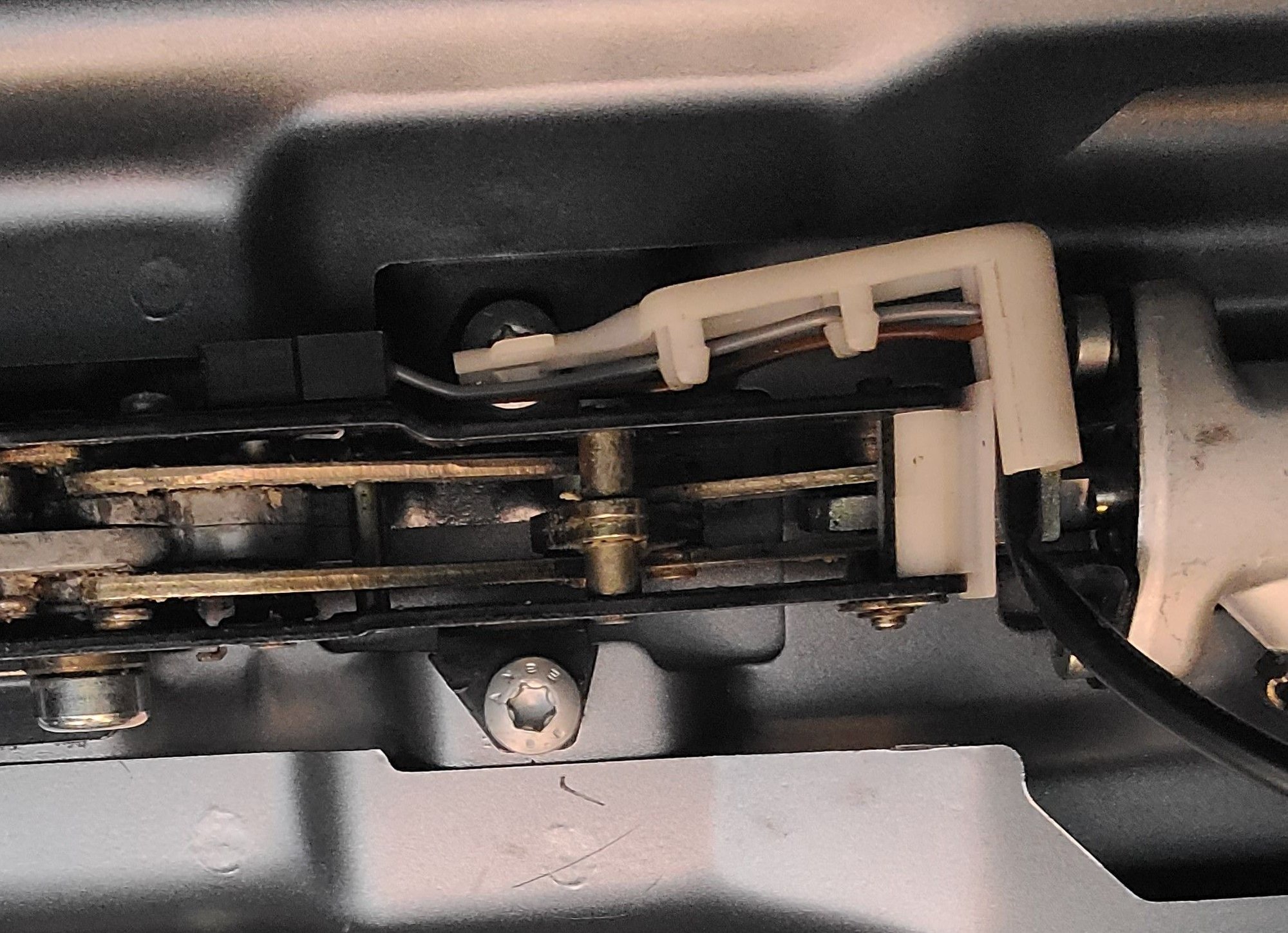

5. Trunk Lid Movement Check
· When the top command is given, the trunk lid should flip backward.
· If the lid does not move:
o Check trunk lid latch sensor. Checked lid latch. See picture for discovery
o Check trunk lid hydraulic struts for resistance. Manually released trunk latch in an attempt to check hydraulic pressure. Unable to move rear window segment to release trunk lid due to pressure.
o Verify trunk lid wiring harness for damage. Check
White, plastic arm not in correct position. Mounting tabs appear broken. This is where I manually release the rear window.

Good Find !!
You just listed some of the reasons I drive coupes.
Hopefully someone with a roadster will chime in and help you correct your problem. Here is a link to the electric lock at the trunk lid latch which must be corrected. Post # 58 gives explanation, but post # 122 has pictures and shows exactly how to complete the process Trunk Lid repair
