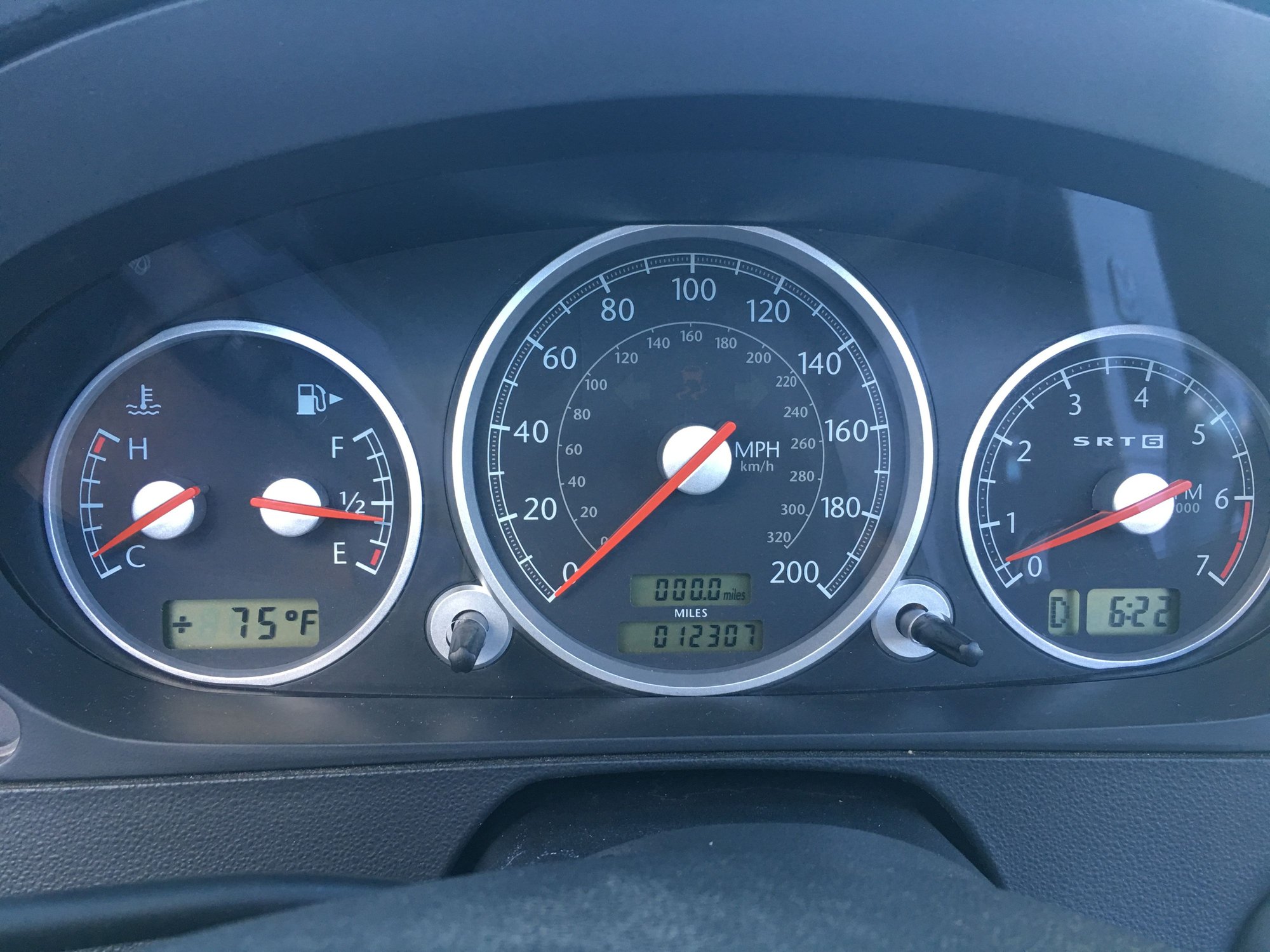

Completed the Sticky key fix while I was swapping out the instrument cluster.
For those of you who have asked but never found the answer, the instrument clusters holds the mileage (or km) from the donor vehicle. I swapped mine from the original NA, which was in KM to the replacement SRT CLUSTER in miles
No programming, it was plug and play. It's a bit of work so if your going to the trouble, then check all of the bulbs before you install it.
