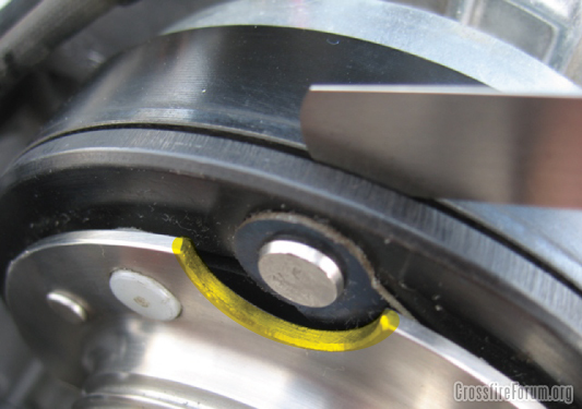

I'm just trippin on that crappy tooling going on these pulley's now.
Check out the highlighted area. Looks like they are taking a die grinder to these instead of having them notched in the machining process.
