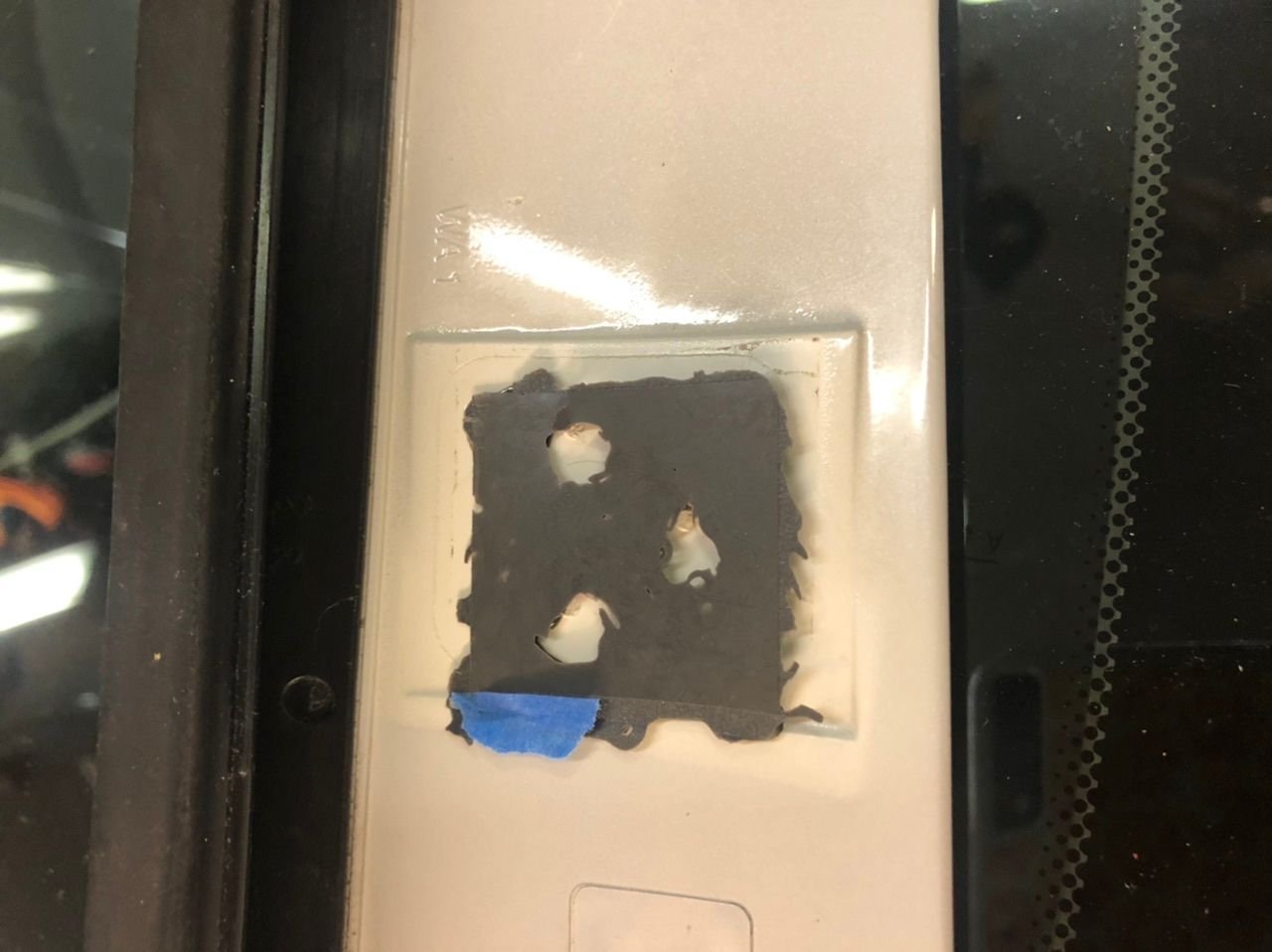

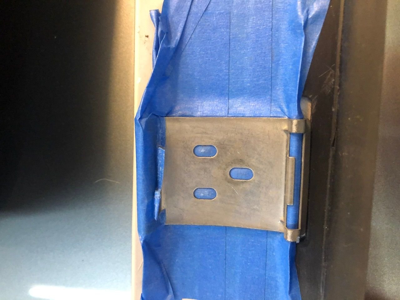

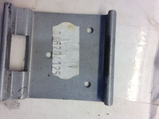

An exterior windshield garnish clip came loose from my Crossfire so I decided to use JB Weld to re attach it. I place some blue painters tape between the two clip so I would not bond those together, I do want to be able to remove it. Anyway, the JB Weld bonded to the clearcoat and paint just fine, but did not bond to the metal strong enough for the clips to separate. What do you think I should do? Can I super glue it back in place and then drill through the holes and place rivets there? I have no idea what’s on the other side and I really do not want it to leak. What’s stronger or better than JB Weld?

I just pulled my repair attempt on the other side. Only now it let go of the trim piece. I am so bummed.

You will note the JB Weld did not fail as none of it is torn apart, it failed to adhere to the surfaces. I have to assume you fully cleaned all surfaces and scuffed the surfaces to be attached. Never skip either step. Never use quick cure. You should also clamp it. Now you know.

What you need to use is double-sided tape that is the same thickness as the OEM tape. Not just any DS tape but a VHB or UHB tape.
VHB is Very High Bond and UHB is Ultra High Bond. JB Weld or any other such cement is NFG for this job.
How thick is the OEM tape? This is an important question as you do not want to use a tape that is too much thicker or thinner than the existing OEM tape.
By coincidence, I have been looking into writing a How-To thread on this subject.
The common 3M DS tape is not the best to use and is outperformed by other common DS tapes, VHB and UHB are the best tapes for the job and come in various thicknesses.
DS tape allows for expansion and contraction of the trim piece, solid setting types of cement do not allow for expansion and are put under shear forces.
The surfaces must be cleaned with alcohol or acetone prior to using DS tape for best results, it should be applied and left for some (?) hours before it is at the strongest bond.
JB Weld is good but not right for this job.

Amazon has it, measure the thickness with a feeler gauge. Some of the industrial tapes are basically the adhesive alone with no core, others are .005, .010, .015 and up, the normal thickness appears to be .040 with a foam core like the regular 3M DS tape.
Just try to match the thickness a close as possible, check the other clips as well. I have not seen these parts close up so I am a bit in the dark on details.

You guys are confusing me. The garnish molding is attached to clips not directly to the windshield frame. The clips on the frame are riveted to the frame. The clips on the garnish molding on my car appear to be electrically plastic welded to the clips and garnish molding directly. The clips on the molding snap into and float on the clips that are attached to the frame. The garnish molding floats on the clips on my car. The JBWeld does not attach the garnish to the frame, but to the clip. I must be missing something and I hate giving bad advice. Please help me out here. Where is this tape you guys are talking about? The only tape I found on the frame area was on the inside under the A pillar covers, protecting some wiring.
The original, from the factory, attachment method is to use double sided tape to attach the clip to the molding. It is done like that because of contraction/expansion difference of the plastic molding and the metal clip. I also go to auto repair suppliers for this, as Jim replied, and most other adhesives, They will have what you need.

As I said I have not seen these personally, so if the clip floats all well and good but never rely on JB Weld for this job.
Double sided tape is the answer so long as it is good for outdoor use, VHB or UHB tape is best, they came to market later than the OEM tape.
As I said before check that all the clips are tightly attached to the trim.

Thanks for some clarity. On our car, of the 11 pairs of clips on the moldings, only 2 were loose when I removed the molding to paint. Upon careful inspection there was no sign of any tape ever being present. I am guessing from what has been posted that these clips were loosened from a previous windshield replacement. It was probably reassembled "non factory" and appeared to be an electronic steel to plastic weld, which failed. Who knows. I don't see any tape at the other clips so it must be under the clips and doesn't show. I am expecting my JBWeld repair to last longer than I do, but if it doesn't I'll uses some real good double sided tape next time.

An 'electronic steel to plastic weld', I know of no such process. Welding is the fusion of the two parts with or without a third material. Maybe there was no tape or whatever, it was left floating?
The thickness of the tape will determine how flush the trim is to the glass. The tape can be .005 thick and up, I would like to know how thick the OEM tape was.
Our man in Puerto Rico Velocabstract added some nice pics but I cannot quite see the fit of the two clips.

Maybe Les can let us know how thick the tape should be, it looks as thick or thicker than the steel of the clip.

I've had mine off twice and replaced tape this last time. I didn't measure it, but approximately 1 mm.

That is the most common thickness to be found, the common 3M tape is about that size.

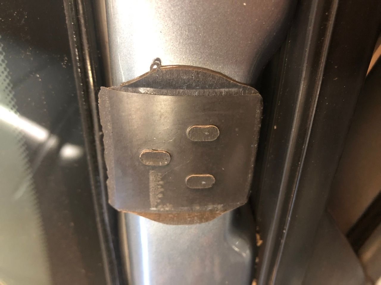

Here's my old thread. https://www.crossfireforum.org/forum...rim-loose.html
The clips are held to the trim pieces with some form of double sided adhesive foam. Usually they clips stay attached to the car when the trim is taken off ... improperly taken off. Pry the clips off the car, use double sided 3M tape to attach them to the trim (you'll see where they were) and snap them back in place on the car. Easy peasy once you know how it comes apart and goes together.
I had to deal with this problem because the people that replaced my windshield ... ahem .... buggered the job! They used windshield adhesive to hold it together until I drove off. Real shady, but they didn't have a clue how the clips worked either. Hope this helps.
