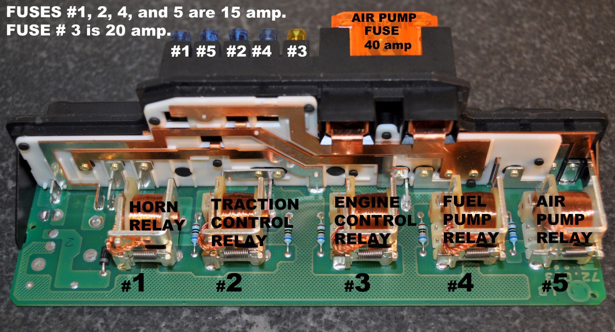

lay the Rcm on top the box there without the case.. turn key and see if relays 3 and 4 close..
Old May 4, 2017 | 12:31 AM
Mrmiata's Avatar
Joined: Sep 2011
Posts: 9,595
Likes: 26
From: Kellyville, Ok
Default Re: no start
If not .. manually close them and attempt to start the car..
