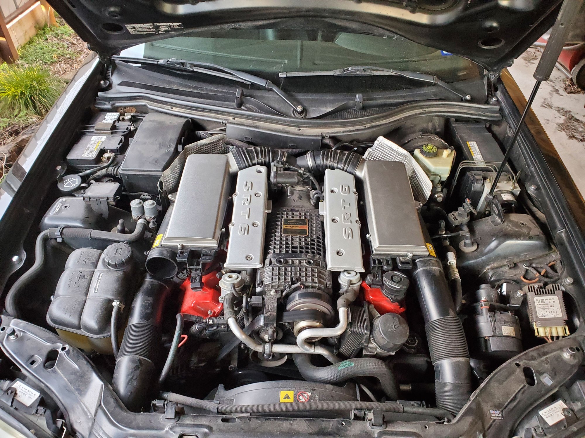

Forgive me if it seems I am lost understanding your post as I do not have the setup you have. A couple questions please?
1. Is your CAI installed with filters outside the radiator wall?
2. Is the airboxes that you have for your CAI sealed to air below them from the engine (I ask because I have no idea what the 'assembled' air box system your mounting to the XF looks like)?
Commonly speaking, the restrictive total used in the intake air flow must not exceed the total of the designed airbox for an untuned engine, within reason, this is why I am asking the two Q's. I ask because I am curious as I do not nor have ever owned an SRT-6 (yet, if ever).
Obviously that added 'item' should not be there, and there should not be more than two filters in the intake air flow system (one each side).
Thanks for responding!
The filters are in the housings, not out in front of the radiator.
The left filter has a tube about 3/4" in diameter that connects to the top of the valve cover. PCV I'm assuming. No PCV valve. No other air can enter the filter housings except for the ~5" tubes that extend from each filter housing into the area beside the radiator on each side.
I'm waiting on a reply from the filter manufacturer for a cross reference as to the application of the charcoal filter that everyone keeps calling a cabin air filter.
I hope this answers your questions. Thank you for input.
In the photo below, you can see that I have pulled the right side air intake tube off of the filter housing. Normally it is connected.

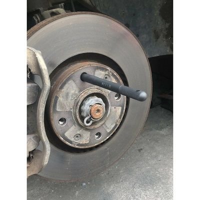

For those of us who frequently take off their wheels , A wheel hanger can save your back and make aligning the holes a lot easier :
Wheel Hanger Alignment Pin Guide Tool - Metric 14x1.5 Threads - Wheel Lug Bolt Automotive Mechanic Tool at Amazon $9
that's awesome! Thanks for sharing 👍 😊
Thank you for explaining the setup in that airbox. Looking up the filters for that airbox should be all you need. Since it (that so called CAF filter in that bracket) is above the hose leading to the airbox and is the filter for the PCV? Good luck, and thanks again for the reply.

I purchased a set from Harbor Freight that fits all the cars I have and is in a nice tool roll there are two of each so it makes it easier to mount the wheel.
https://www.harborfreight.com/wheel-...gg_q=wheel+pin
Thank you for your reply.
My guess was that it is the PCV filter to slow fouling the regular paper filter. I will reinstall it.
EDIT: THE PAPER FILTER IS "IN FRONT" OF THE CHARCOAL. THE CHARCOAL FILTER DOESN'T STOP THE CRANKCASE VENT FUMES FROM HITTING THE PAPER FILTER. I DID NOT REINSTALL IT.
I sent a message to the manufacturer, "Mann", here is their reply:[After further discussion and research it was determined that AE 2501 is made for a private original equipment manufacturer.
It is not sold in the aftermarket and no other information is available on the product.
[color=black]Thank you,
Mann+Hummel Product Information
