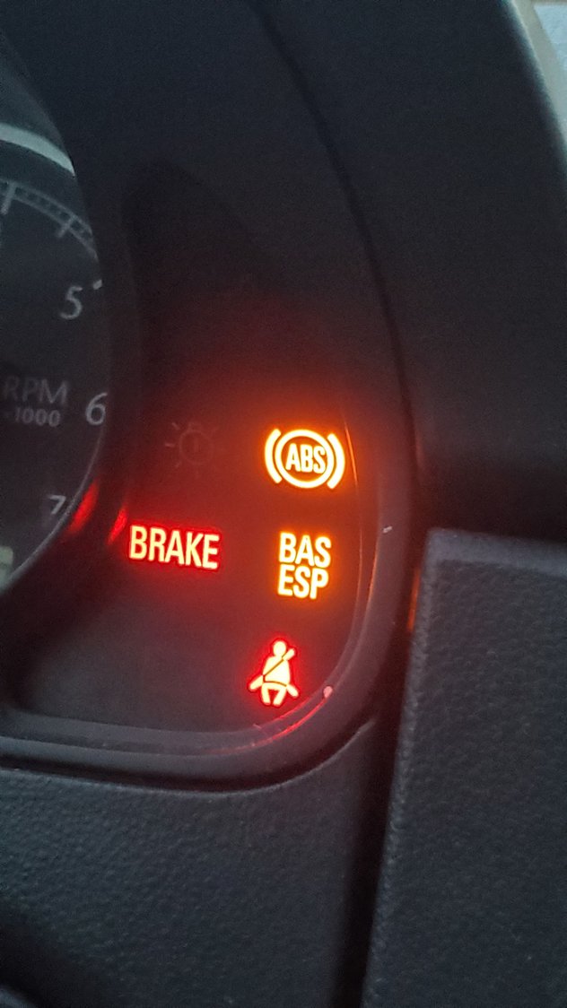

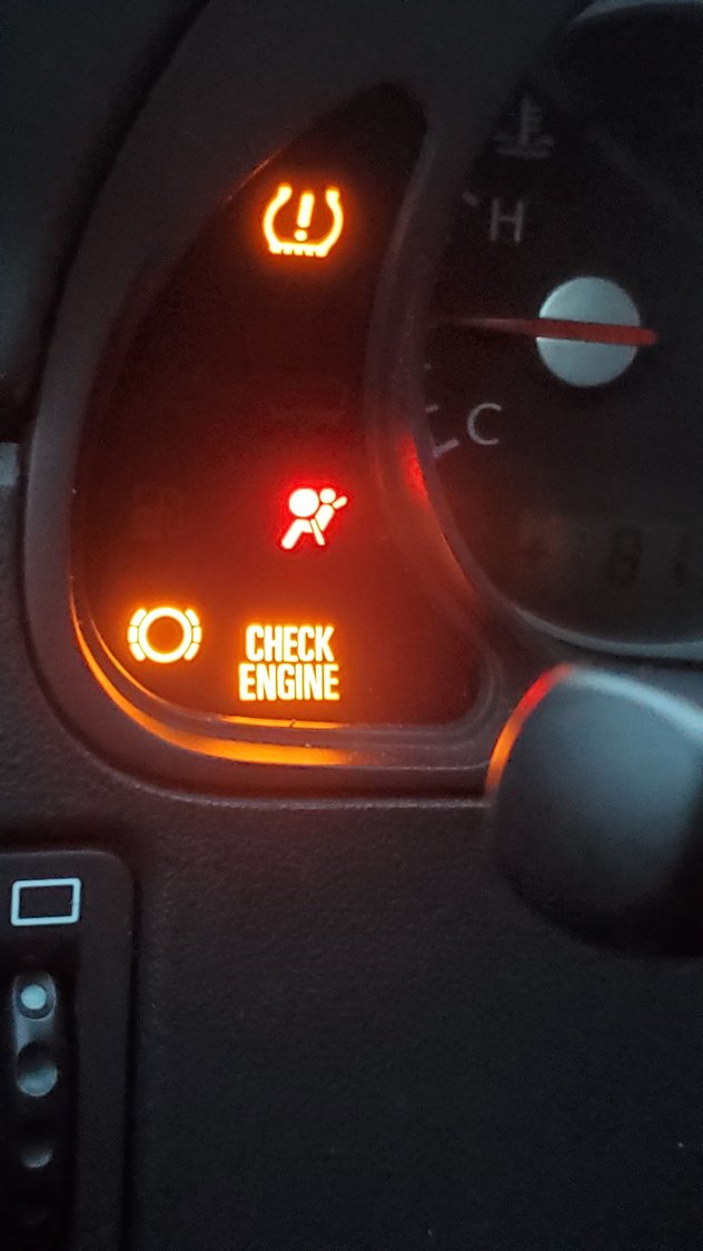

Hello, this is my first post, I'm am sorry if I am posting this in the wrong place but I really need help. I have a Crossfire that has been sitting in storage since 2018, but the car was in good shape when we put it in, about 45k miles when we put it in the garage. Recently I decided to get it running so I bought a new battery and installed it, the car started without any problems and EVERYTHING worked (with the exception of the spoiler but I'm not worried about that right now) Some problems I notice right away are; Check Engine, Brake Wear, Tire Pressure lights. This isn't that big of a deal to me, engine running smooth as silk, i had replaced most fluids so it had to be a minor issue, break wear light, just need new brake pads, and the tires needed aired up (im assuming the fixes to these problems, if this is more problematic than i think please let me know.) I do a short test drive to dump off a bag of trash and drive back, no issues.
Left of steering wheel
Right of steering wheel
This is when it hits the fan. I park outside of my garage and start doing some work on it, cleaning out the inside, putting in new window washing fluid (its leaking, please help with that too if you can) and cleaning wipers. It starts getting late so i go to put it up and continue working tomorrow, I start it up and a whole bunch of funny new lights appear (pics attached) these were not on before, I press down on the break pedal and it press normally, but I cant change gear, its locked in park. I put the cover on it and started googling when i found this site. Any help appreciated, thanks!

For clarity, BRAKE, ABS, BAS-ESP are the new lights
