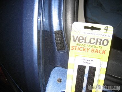

Guys, be sure to check the rear plastic trim in the trunk, it's just under the hatch and it rattled on mine. Tap against the lower part of the trim to hear the rattle. I put rubber weather stripping at the bottom of the trim and the rattle went away.. I also put felt strips on the gutter where the rubber stops contact the paint. This protects the paint and gets rid of any gap.

The latch is okay but the rubber stoppers are a crinkle-cut pattern and I can actually see the crinkle-cut embedded into the duco where they come into contact with the gutter. I figured the little rubber feet flex as the hatch flexes so for a work-around fix I put some loop adhesive Velcro where the stoppers come into contact with the gutters. Cured the issue.
Cheers
Sean.
Had the same issue with mine, the bumpers had actually wore a footprint down thru the paint to bare metal.
I used 3M Weatherstrip adhesive to glue two small strips of thin rubber to the gutter where the bumpers seat and problem fixed. The rubber was thin enough where I didn't have to jack with re-adjusting the bumpers.

Many people use the soft side of adhesive velcro strips. Adds a little padding too.

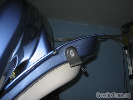

Can anyone take a picture of this??? I don't know which bumpers you guys are talking about...!!

Very first MOD I ever did on my Limited Crossfire - & the first mod on my SRT6. (Second was the speaker capacitor) - Cheap and Easy - Just how I like it!! - go to any store for the fix - Use the "Stiff End". As all guys should. 9 Mos later - still no issues.

I took all my strips off. With the tape on the latch bar, there is no need for the other remedies other than just protecting the paint if the factory clear protectors are gone.
