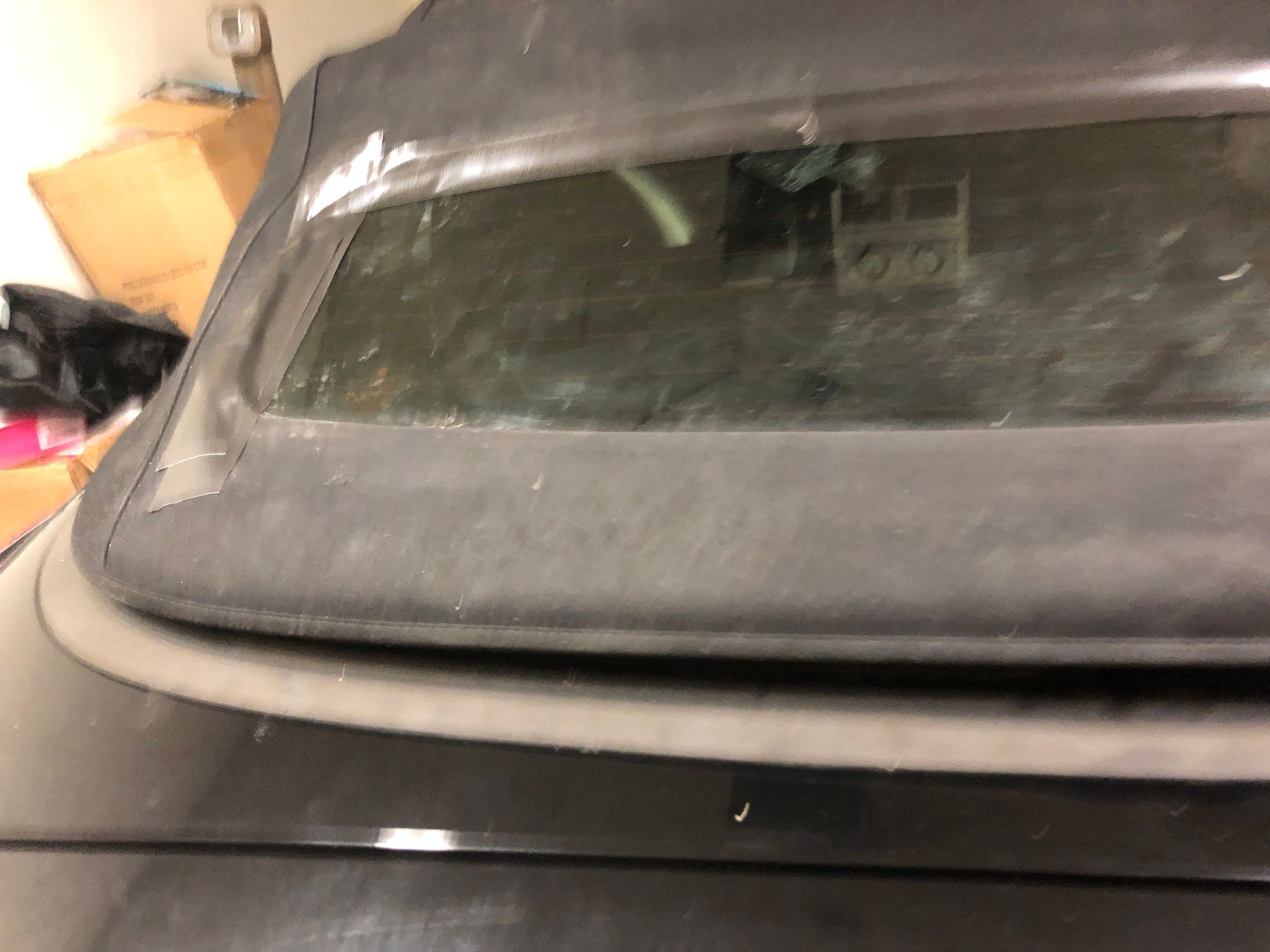

Ok so I replaced the trunk actuator and glued the window but the top still will not go up or down. I attached photos to show the position the bow is stuck in. I just ordered the multi purpose tool and I am going to try to lower and raise it manually in hopes of resetting it. Any put is appreciated
Fixing rear window excuse the mess
Latch for bow stuck
