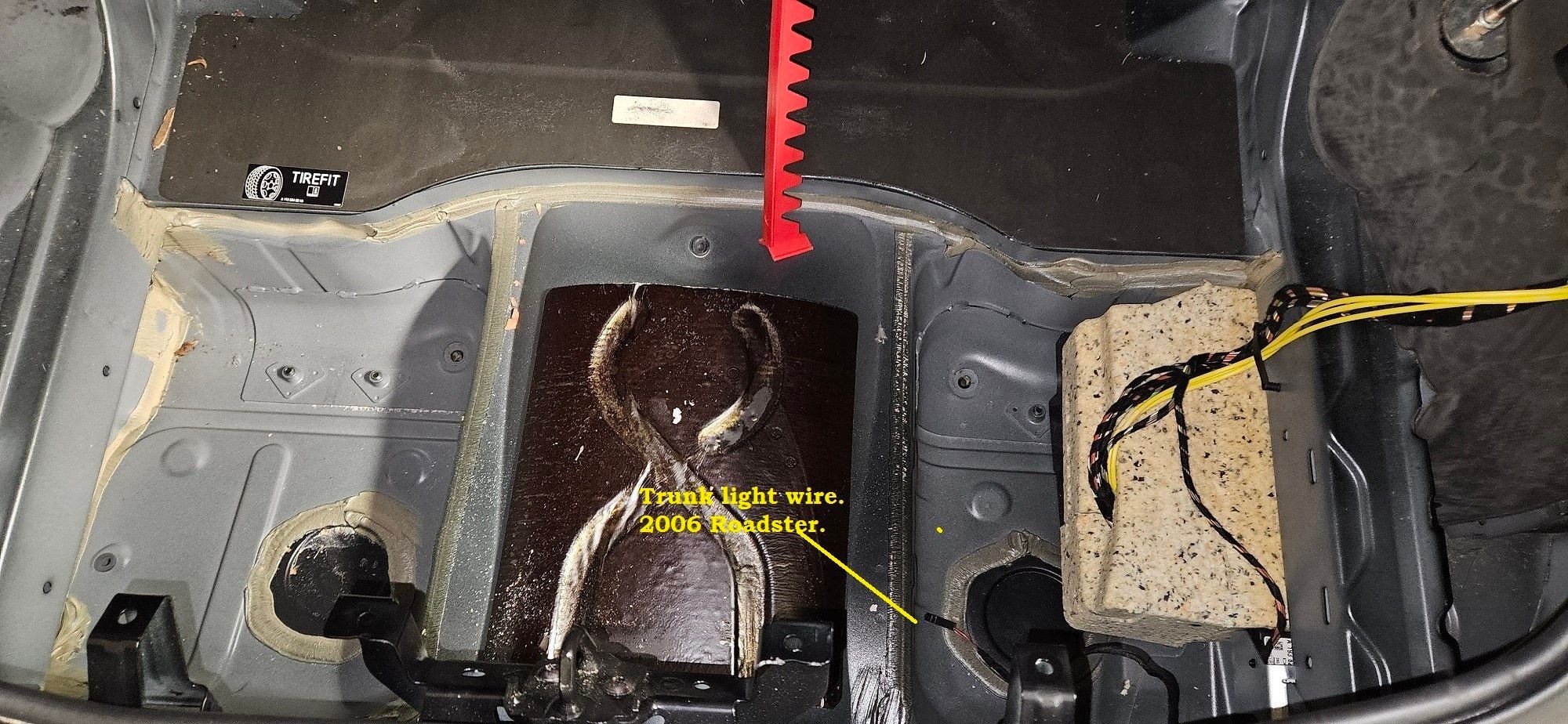

Going back to your original photo, I still believe that wire is for the trunk light.
here is a picture of mine. It seems to be the same connector. I'll take a picture of the actual light in place, the wiring and the connector tomorrow. Maybe it will help.

I took some pics of my trunk light and connector so that you can verify whether it is the same wire that you have.

The trunk light is on the left side of the trunk.
