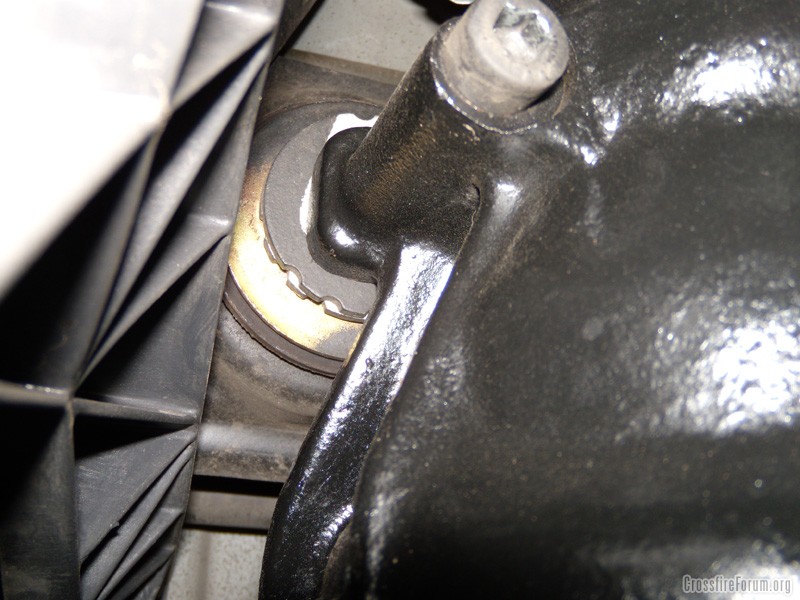

ok i have a problem and need some help!! the front bolt that holds the diff up . on jhm2k's car theres no play at all. on mine theres at least 1/2" to 1" of play were i can push the front of the diff up and down. i tried jacking the diff up and retightening the bolt but its tight and when released the play returns. does anyone have a foto of the front mount bolt and the way the washers and rubber bushing install? i feel like something is missing and need to figure it out so i can get an alignment and learn all the new mods on the car

not concerned with the alignment as i also have new tires and wheels so i would realign anyway. its the front bolt assy i need to figure out. cant have this play as i can hear and feel the diff jumping on accerlation . needs pics of the front mount assembly to see what im missing

Default Re: *Needed* 20 to Pre-order Wavetrac LSD for SLK32/SRT-6
Steve... I went out and jacked up mine and here is a pic of the differential front mount.....
Is it possible that you stuck the wrong bolt in there and it is too long and bottoming out on the frame??? Just ideas...
thax for the pic mike. only 1 bolt up there no way to mix it up. but i think im missing the brass looking spacer. actually the mercedes epc diagram shows a host of spacers and washers (about 6 total) so i orderd the kit and ill install it this weekend.
