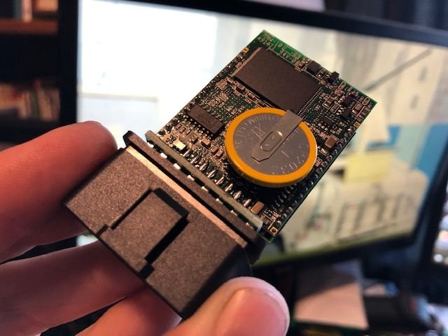

I thought i would add a small snippet of info regarding my experience with the Witech system setup.
So i decided to order a "Witech V17.04.27 Micropod" kit. If you look online there are many options to choose from. I was initially going to order one from the obdii365 site listed earlier, but i had a slight change of mind and ordered one from a seller on aliexpress that would be shipped quickly via courier (dhl in my case), just search for item 32995661303 on aliexpress(https://www.aliexpress.com/item/32995661303.html). It was 167$ cad for me. They had 2 versions, one with a Hard Drive and one without. If you want to go thru the process of setting up the software, choose the cheaper "without hard drive" version. I had messaged the seller if the CD had the DRBIII files on it, and they said No, but it did have the files anyways... lol?
Package showed up, and it had the interface dongle, usb cable, and software disk. I made a backup of the disk and uploaded it to my drive for all to have, John also is sending me a copy of his version of the disk so we can compare differences. I will also upload his disk if it has any differences. It just under a 2gb package that i put in a single rar file, that contains 2 versions of the witech software, the DRBIII files, as well as a simple setup video that is not exactly helpful.
