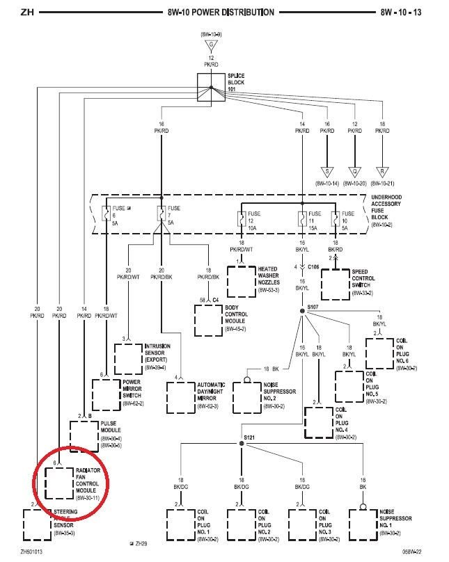

Old Mar 3, 2020 | 06:32 PM
Likes: 1,298
Default Re: Cooling fans won't stop running with car turned off
I dropped my crystal ball the other week so I cannot see what the problems are.
The only way it can NOT be a bad fan module, is if the ignition feed to the fan module is always hot.
I don't see how that line can be hot all the time without a LOT of stuff still being on - he would see that.
The ignition feed to the fan module is from splice block 101:
