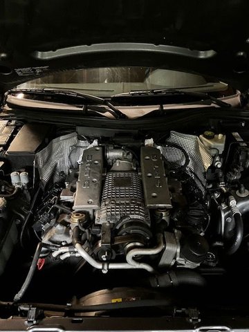

I've been a motor head since I was a kid, but the Crossfire completely escaped my notice until about two years ago. I searched for quite awhile and eventually purchased a 2005 SRT6 coupe from a fellow in Minnesota. 66k miles and well cared for (but no maintenance records &#128577 from the git-go, I had a problem with a misfire. First, changed all the coils and plugs, spent a bundle at a couple of well respected indie shops trying to track it down. Got almost no driving in my first year because I didn't want to drive with a miss and risk killing the cat.
Eventually, I noticed that even if it started with a miss, after a minute or two, I could shut it down and restart and she'd be humming on all six cylinders. Sort of like a re-boot. As we're just getting into the new driving season, I thought I'd reach out and see if you folks had any intelligence on what could be causing this intermittent miss.
Attached a few photos of my coupe, called "Frauke".
Thanks in advance for considering this request.
