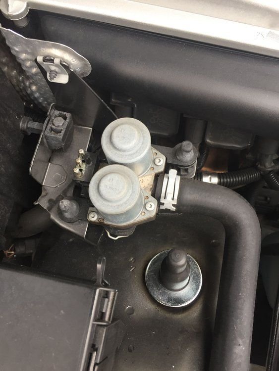

Replaced RCM with spare, as M60A3Driver siuggested, but has same ramp up condition! What's a DUO Valve? Any suggestions wherte to go next? What does the fan control module look like and might it be the problem? Thanks
Found it and guess it's a mixing valve for climate control. Don't know if it would have anything to do with the radiator fans ramping up though. What ya think?

A bad Duo Valve, coolant flow, can cause this. It may need cleaning / rebuilding.

When I get a chance I'll switch out the RCM with a spare that I "think" is good. Have a few chores that need attention before I can get back on the troubleshooting!
CAR **** ALERT!!
